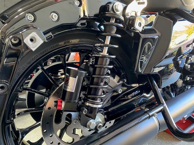

NorthWestern,
I cannot comment on the S36's, however, I recently added Russ Wernimont RS1's to my 2019 Street Glide Special. They are significantly more effective than stock shocks. The ride quality is remarkable...like a Cadillac ride with Porsche's response. I would highly recommend replacing your stock shocks with whatever you feel comfortable buying...you will not have any regrets.
Semper Fi
New RS1 Shocks...

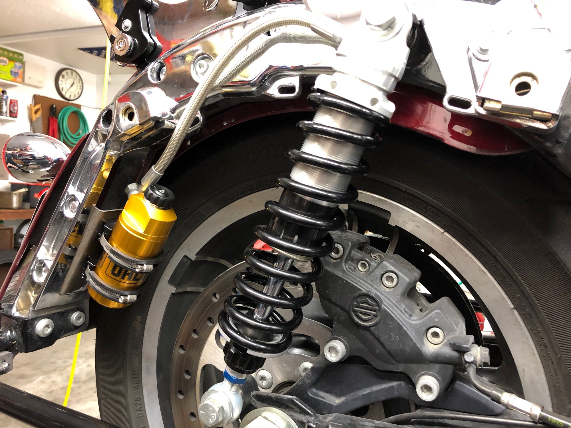

We added Ohlins HD357 to our '16 RGS. Top of the line and certainly the most expensive but we couldn't be happier with them. I'm 200 and my wife is 125 and the factory suspension was junk. Any aftermarket shock would be an improvement. The only downside is that once you fix the rear you find out how bad the front is as well.
A couple of observations. First, the HD357s show to be for 1990-2013 model bikes. Your bike is a 2016. Second, is that photo before you adjusted the spring preload?
Well, you certainly have my attention. I was told these are the correct shocks for my bike and I was also told that they were setup for us. Now I have doubts.
