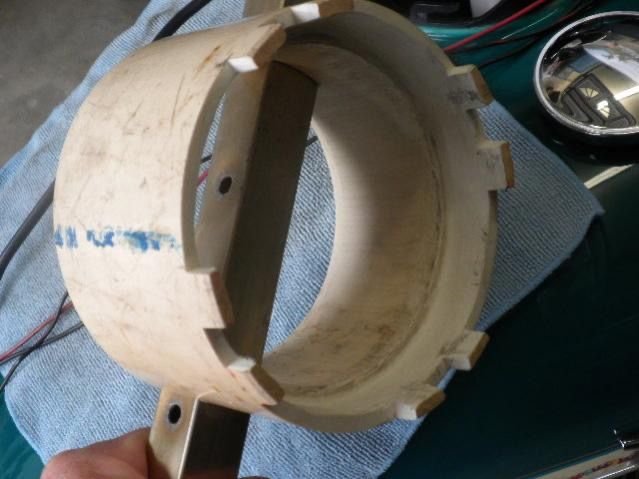

If you have 3D printer (you or a friend of you) you could download it from thingiverse for free and print it
https://www.thingiverse.com/thing:2815807

This photo has been posted on here before
