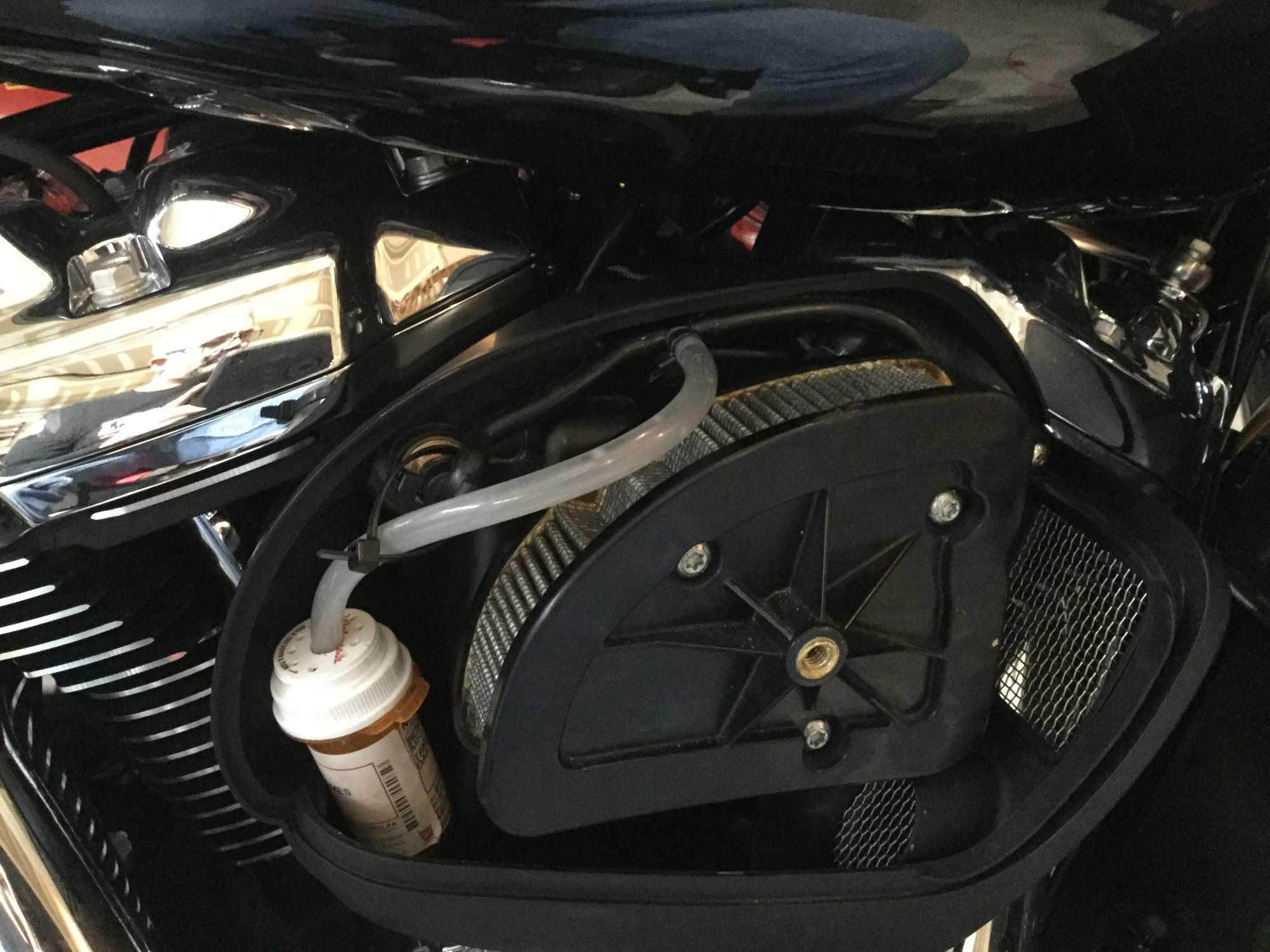

There’s a couple of threads on this with plenty of pics, here’s mine or you can just run down and under the frame like stated above.

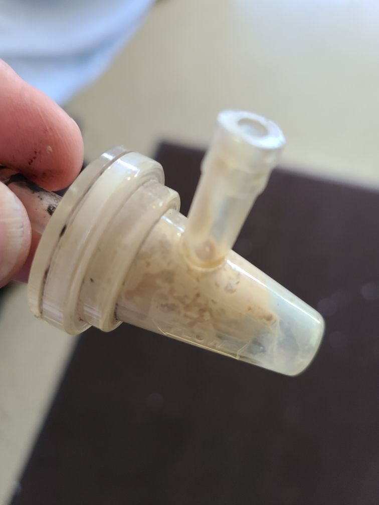

I used to use catch cans but they became a pita after a while. Now I run the hose to the bottom of the frame and attach one of the 90* filters below facing down and to the side. Works like a charm and I just swap them out at the end if the season....cheap enough!
https://www.ebay.com/itm/5X-Clear-In....m46890.l49292
here's a pic of the last one I changed after 4000 miles. Most of the time it had clear liquid in it but I changed the oil and slightly over filled it. After 300 miles this was in it.....I changed it out and took some oil out. Now it's back to normal.

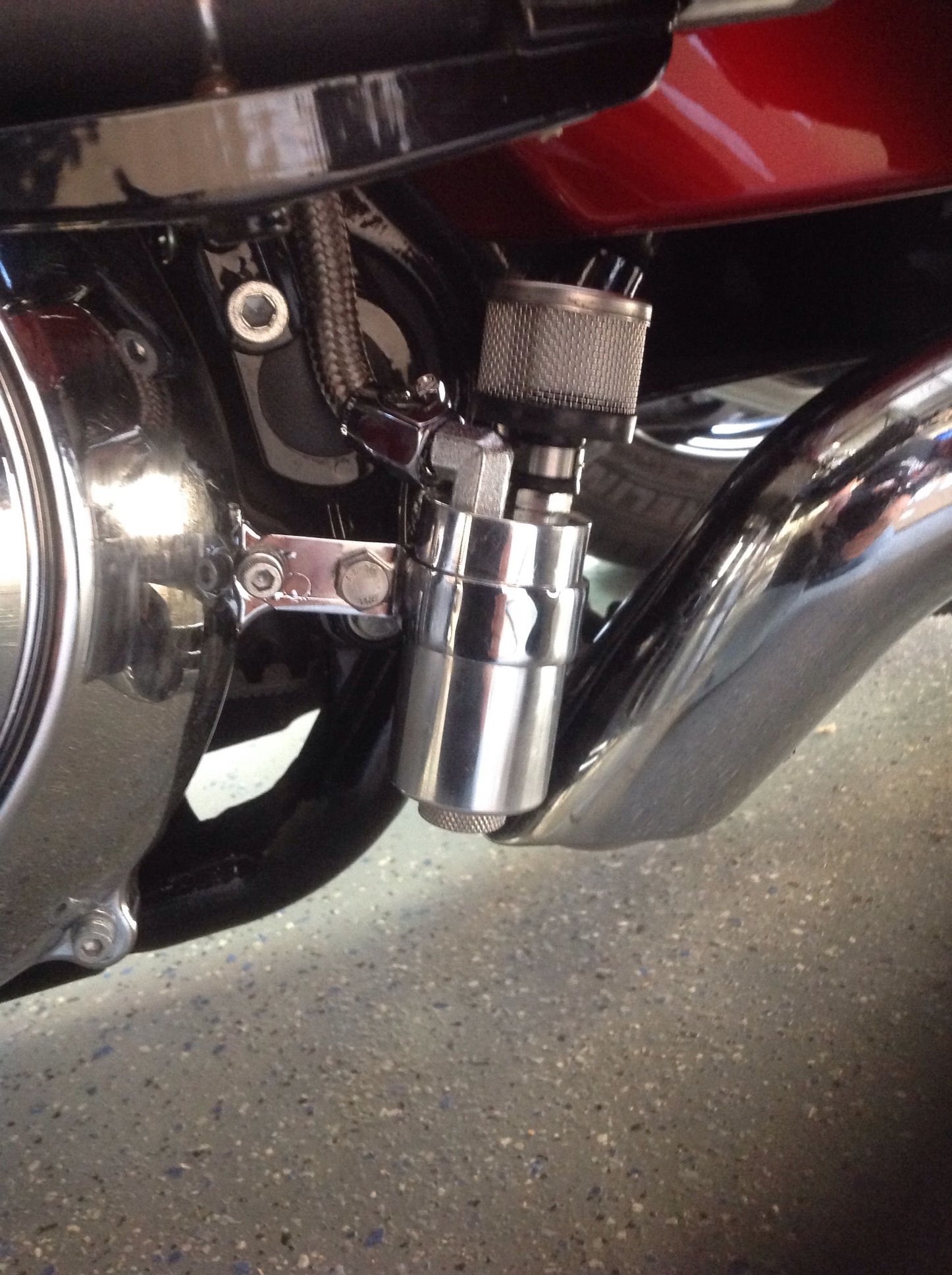

This is the installation on my TriGlide. I think I bought he catch can from JP. I’d empty about a tablespoon of glop from it every couple 1,000 miles. The only downside was I could smell combustion odor when stopped and the motor was running.
