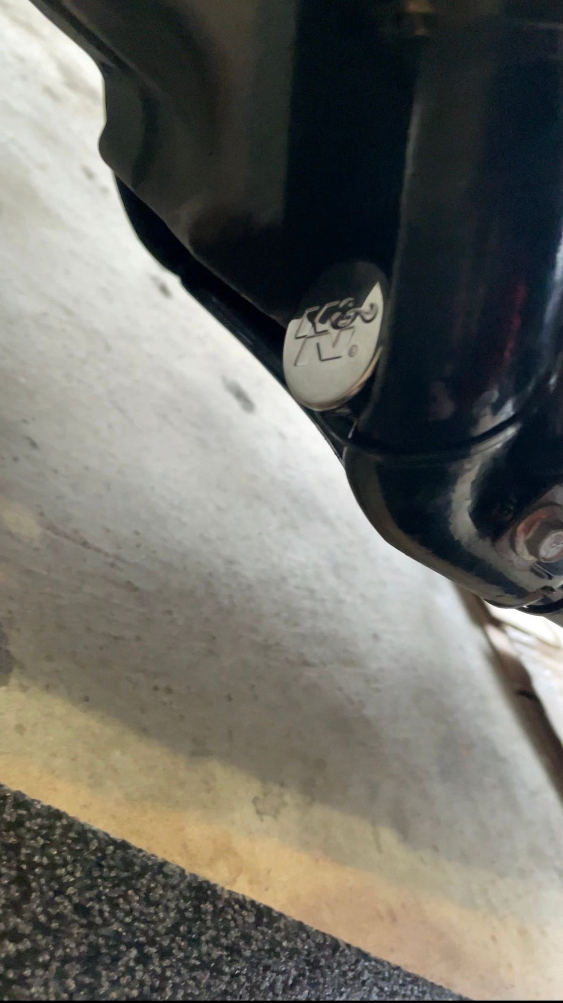

Not a fan of a catch can style setup, I'm a vent to atmosphere kind of guy. Especially those metal ones hanging and possibly banging around. With that being said, I do get a little worried about the slim possibility of oil getting on my rear tire. I ran tubing straight down from the backing plate, under the tranny side cover, and zip-tied a very small K&N breather filter on the end. This way, I have constant venting and no restrictions, and almost no possibility of pure oil making it to the tire.
