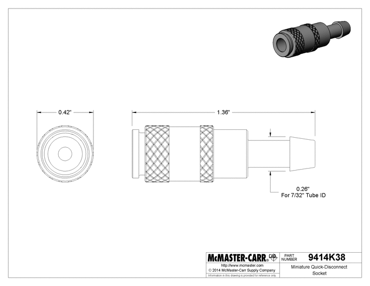

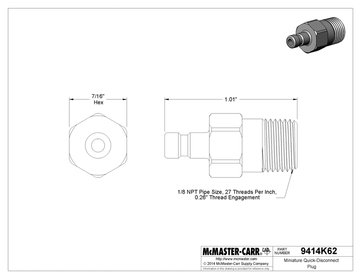

Originally Posted by lenbt
You have a pic of those Mcmaster fittings?
I'll take photos of them installed on the bike tomorrow. Plug goes into the threaded hole in dipstick cap. Socket barbs with hose clamp into hose.
