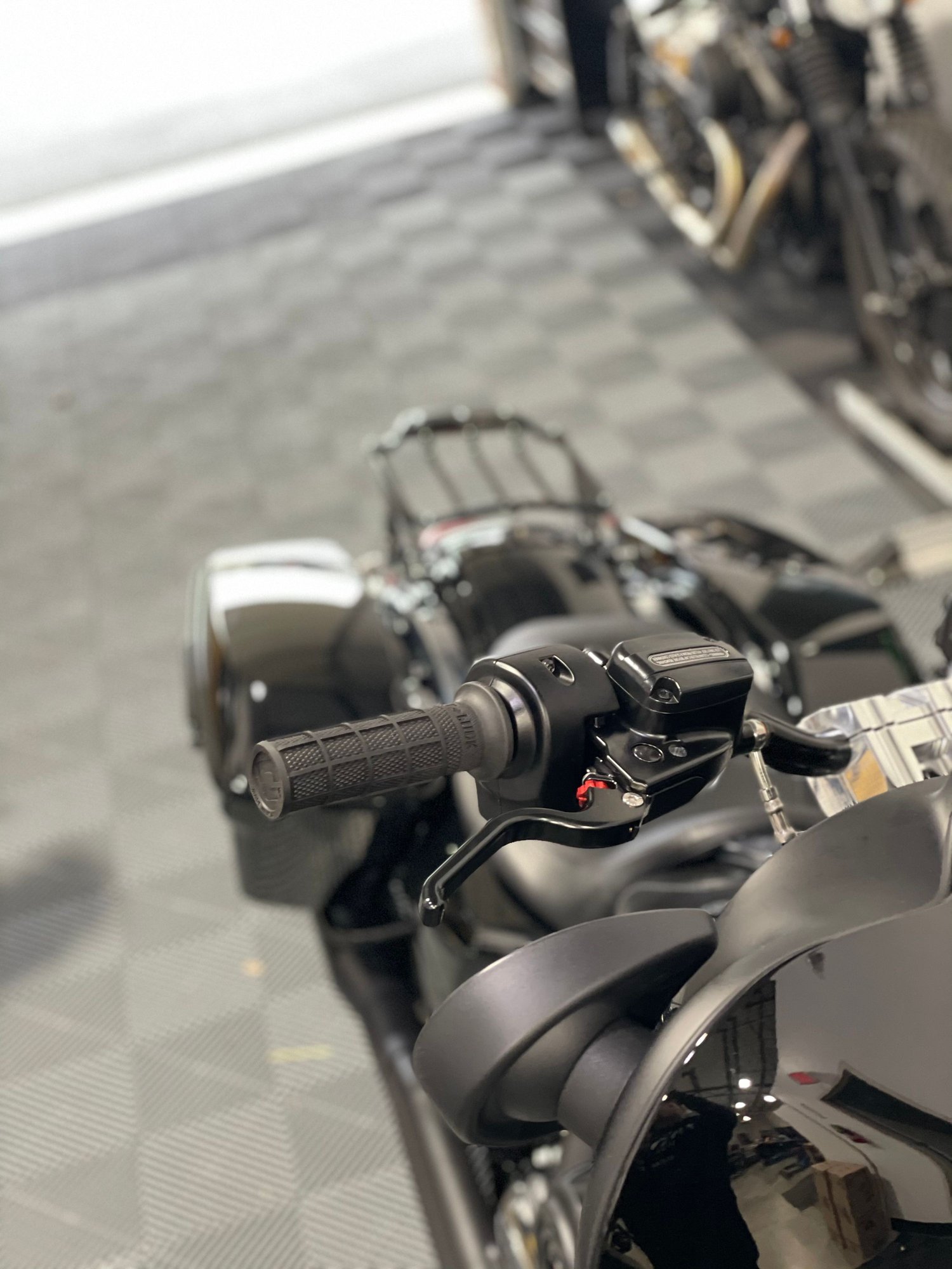

Hi all,
Was wondering if anyone has installed these and if you liked or not. Not so much worried about my current clutch pull, just need some levers that are a little closer to the grip. https://1fngr.com/

I have similar levers from Oberon. They are definitely helpful in various situations, especially the clutch for parades or drills.

Be aware that on some of these adjustable levers if you get it too close to the grip then you won't be able to start the engine with it in gear. I bought a set of PSRs and they were that way so I sent them back. Kill it at a stoplight and you'll first have to find neutral before you can start engine.
Ended up bending my stock lever and the removed some material that contacts the switch. Several threads that walk you thru the process.
