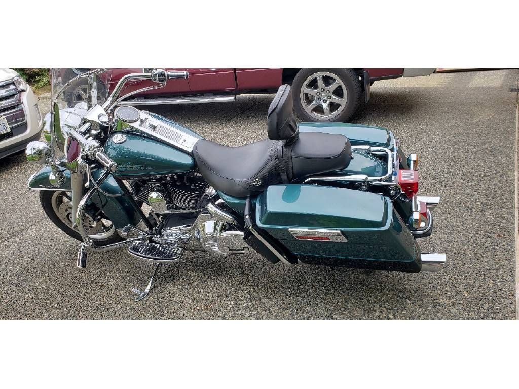

I recently jumped on a Y2K Road King from a older rider that couldn't handle it safely anymore he worried after a close call
3200+ original miles... garage keep always.
I won't post what I stole this King for to keep the hate out of the post.
It's all original including the carburetor.
Looking for suggestions on what new carb I should go with.
​​with.Not Looking for speed (It's an 88)
But want to strap the best it will take.
Any & all replies would be appreciated!
