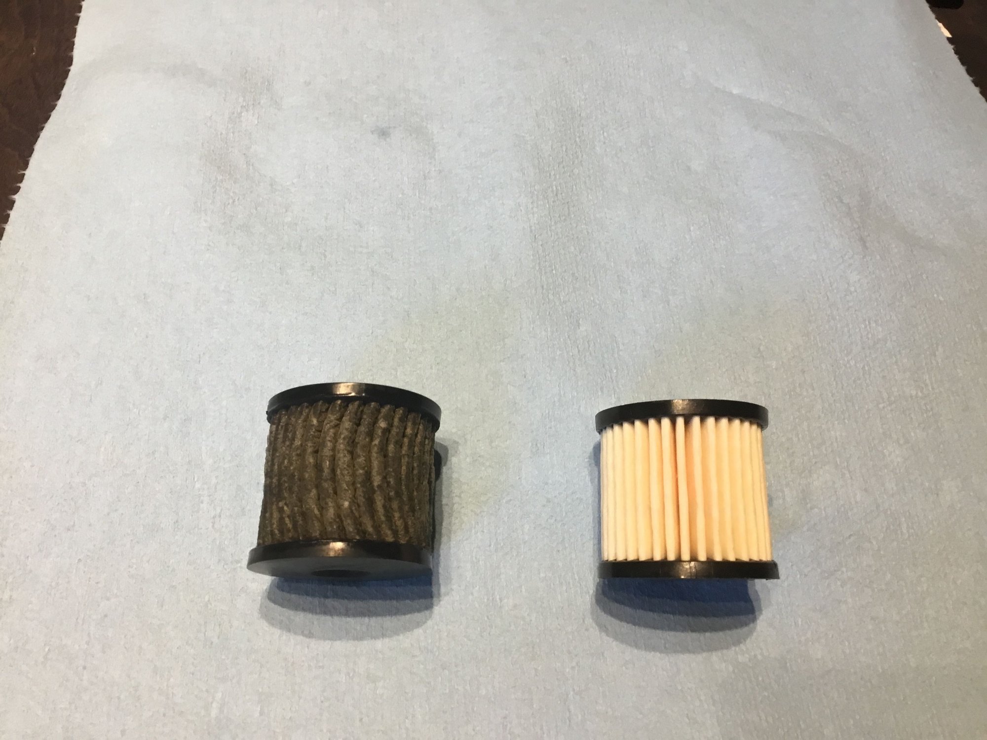

Hey, I have a -09 Electra that has been sitting with old fuel for roughly a year, last time it was started was 8 months ago.
The bike didn't start and I have tried following:
  • Replaced the battery with a new one.
  • Replaced the old fuel with fresh fuel.
  • Checked that it has spark.
  • Replaced the starter relay with a new one.
I can hear fuel pump buzzing when i turn on the switch but It seems as it doesn't get fuel.
  • The bike started when tried with start fluid at the inlet filter. Runs on start gas and then it dies again.
  • I emptied the tank again and replaced the fuel filter inside the tank with a new one, the old filter did look really bad after 12 years.
I have it assembled again but do you have other ideas on what to check before I fill her up with gas?

You already have her back together with a new filter and fresh fuel. Give her a whirl. If she runs adding sea foam will help clean things up as well.
did the filter look like this
That was my 2010 last year and still ran like a champ.

The fuel filter looked swollen and discolored but not as black as yours.
