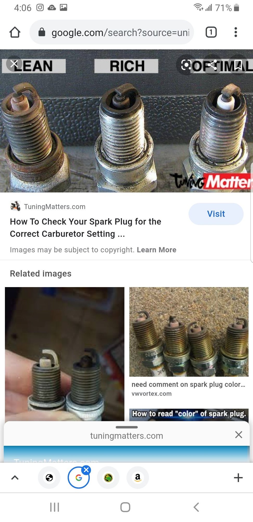

Purchased a street glide that has a spot on the chrome pipes that is starting to turn yellow. From research I've come to understand that could be from the bike running too lean. It does have a SE kit. What would I need to do in order to prevent any further yellowing or to make sure it's not running too lean?

Pull the spark plugs and "read " them. There are charts you can google to compare your plugs to see if you are running too lean or too rich. Yellowing pipes usually indicates too rich or it's yellow before turning blue. Blue too lean. Sounds like you need a new tune. It could also just be cheap pipes and cheap chrome.

I was looking at pictures earlier on the internet. when you say "new tune" are you referring to the SE Super Pro Tuner needs adjusting/updating?
