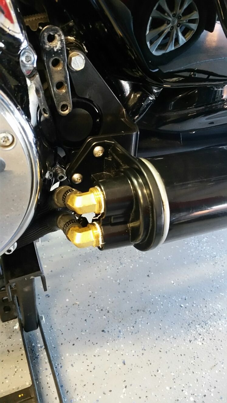

I use the relocation kit from DK customs. No more mess when changing oil.

I like the relocation method but I already moved my cooler out there. The bag method looks good too but I think I’ll try the drill-a-hole method next time.
