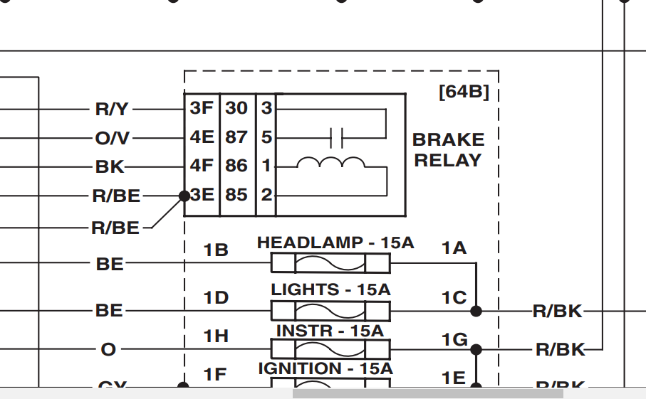

You're right, when you pull the front lever you are probably hearing the Brake relay energize.
First check your bulb and make sure it is good. Does the R/Y at the tail light have 12V to ground when front lever is pulled?

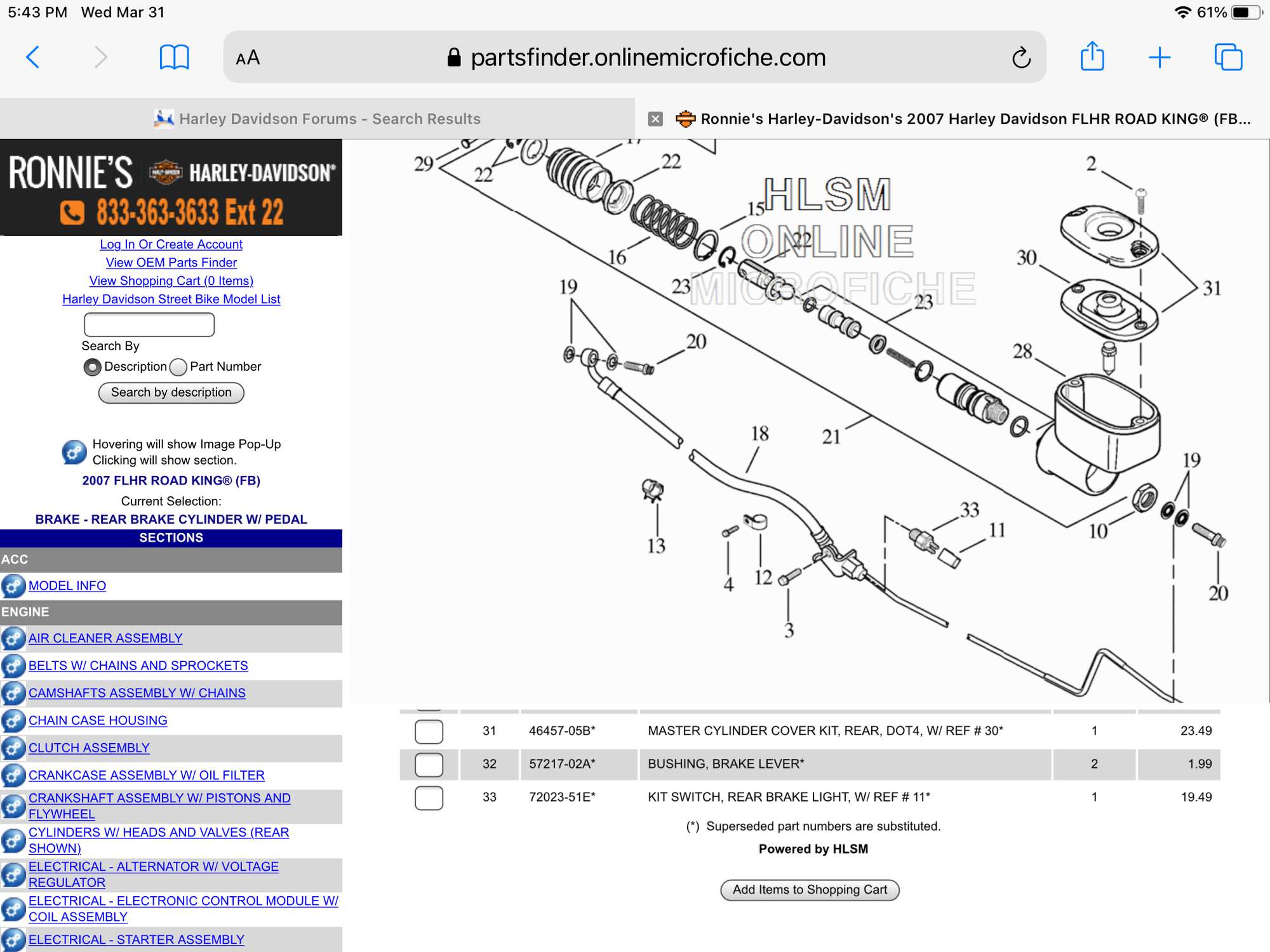

Silly question!!! Where is rear brake switch,, i cant find it, bike has very primative abs(police model) if this helps
Old Mar 31, 2021 | 06:49 PM
Vernal's Avatar
Vernal
Joined: Apr 2013
Posts: 7,681
Likes: 8,413
From: Utah
The master cylinder for the rear brake is attached to the brake lever. The switch is just to the left , towards the engine, of the master cyl. #33 in the parts diagram.
