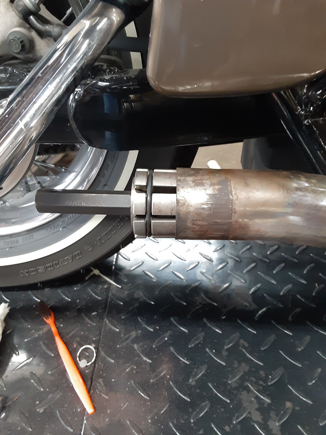

Thanks for all the replies, all good suggestions. I do not want to kick mufflers back. I have a nice set of stock mufflers. Inlet outside diameter is 1 7/8. Header pipe inside diameter is just a half hair under 1 7/8. Can almost slip muffler INTO pipe. I think header pipe can be expanded just slightly and it will go. As long as it is a nice snug fit it should not leak even though pipe is fit over muffler inlet, not inside. There are two joints in my Panhead dual exhaust that slip over instead of into the next pipe and that is factory and they don't leak so I am going to try it. I'll update.

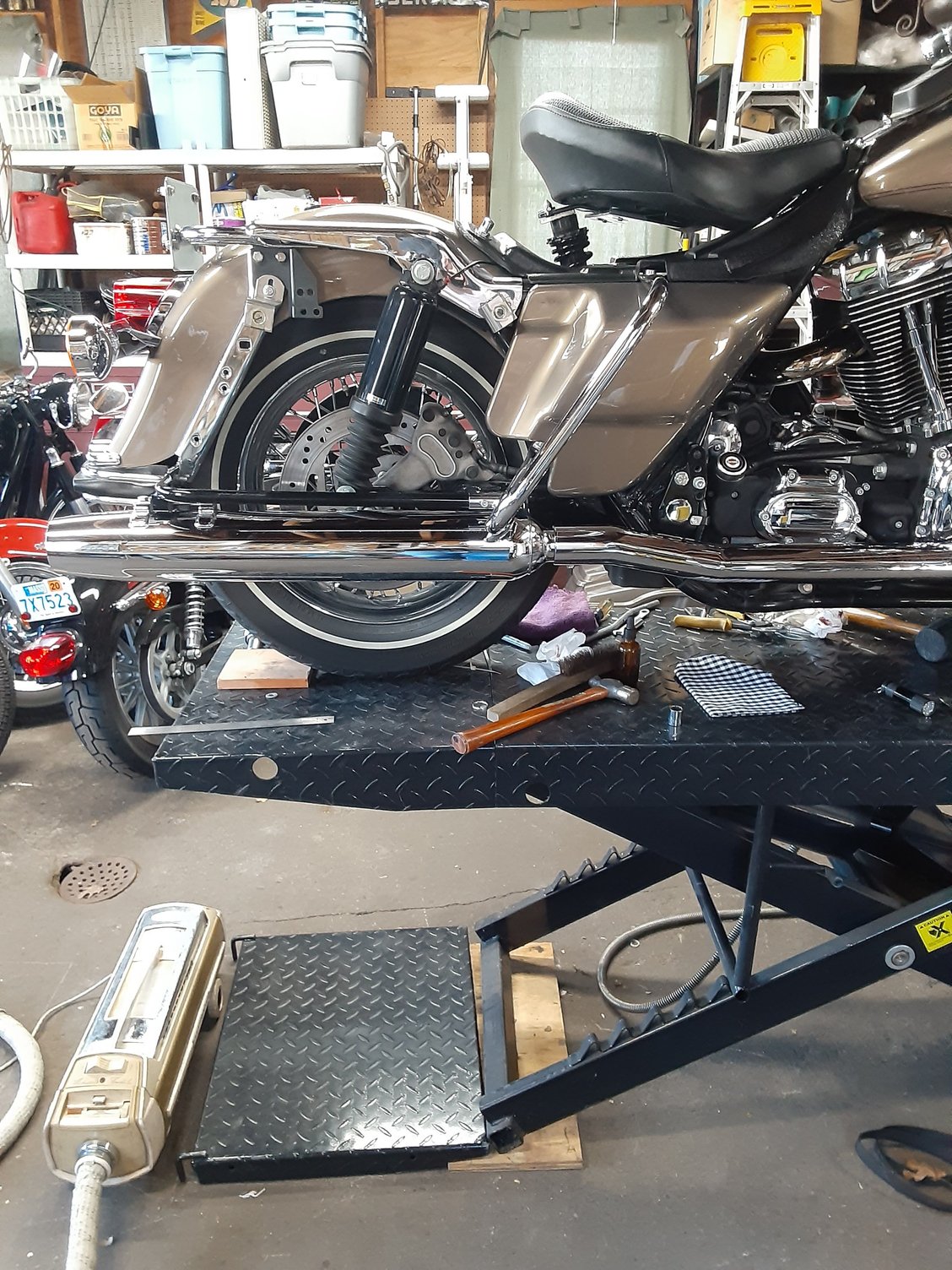

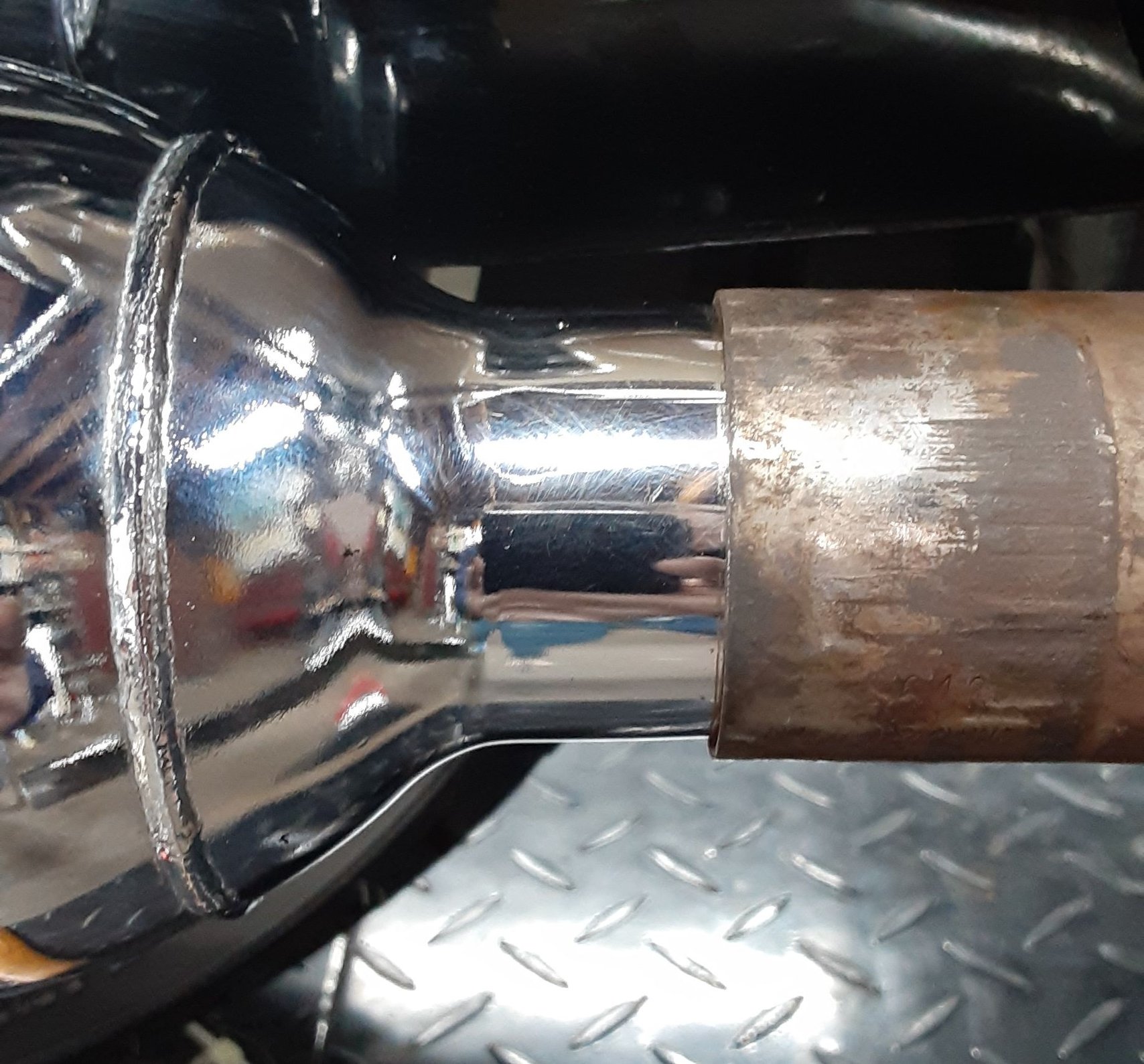

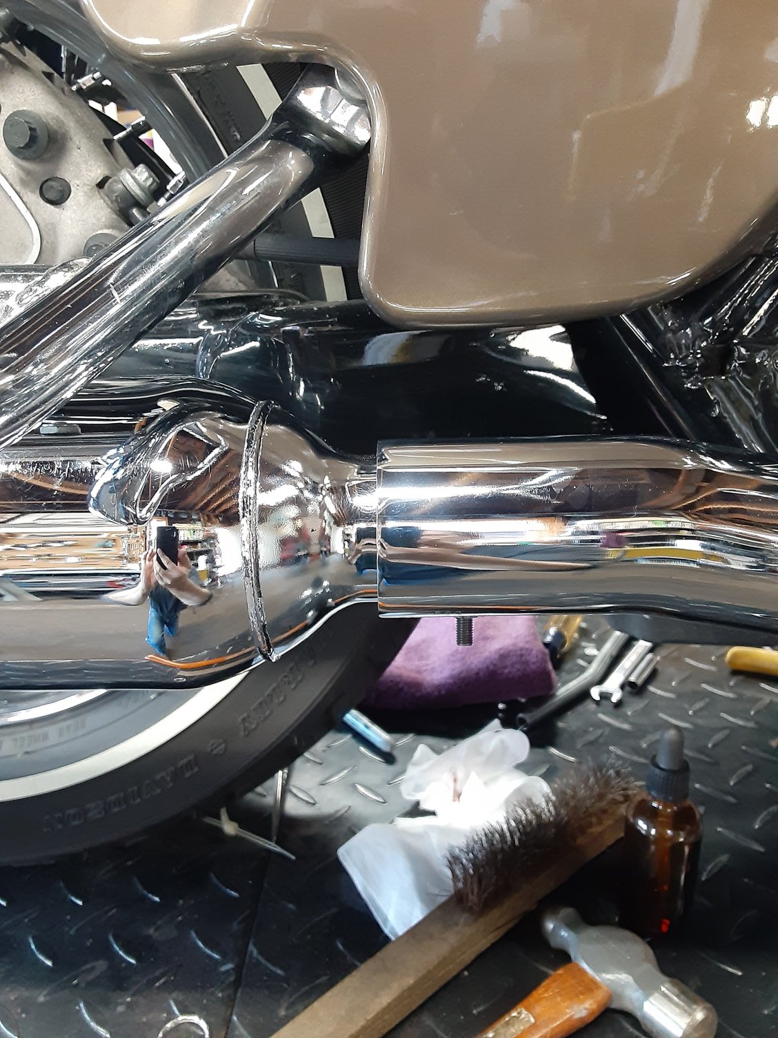

You may be right klc about the odd diameter. This is what I've done so far. Have successfully expanded head pipes to accept muffler inlets, nice snug fit. Next I'm going to slit head pipes per Senecagreen's suggestion and use clamps that were on there (the stock Harley clamps are too small and don't seem to want to expand around the 2" pipes). Just for good measure I'm going to use some Ultra Copper high heat silicone on joints. I'll update when done.

Update: got stock mufflers on. Did not slit head pipes, did a test and clamps squeezed nicely. As long as high temp goober doesn't fail it will be good.
