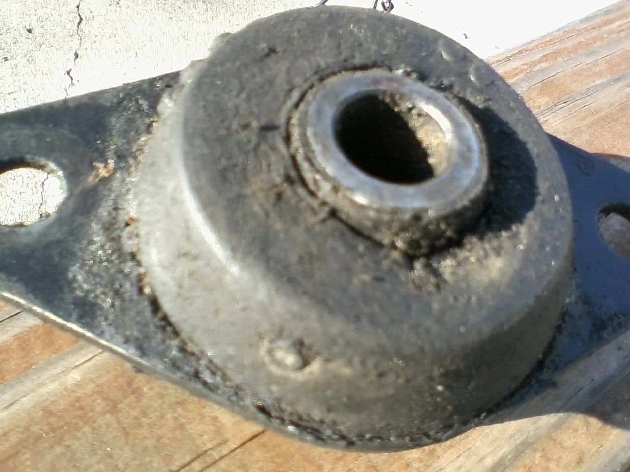

If that’s your original motor mount in the video, you probably need to change it. It’s often hard to see any damage until you remove it. This is a pic of my original mount. Looked ok until I removed it. Replaced it with a glide pro.

Talk about night and day. WOW!!! The old one wasnt cracked but it was very soft compared to the new one. Once I had it out I cleaned up the frame and installed the new one
Heres the before and after videos. It said 35-45lbs so I went to 40 for now and see how it goes. Went from the instructions on the forum. Thanks guys and forum
