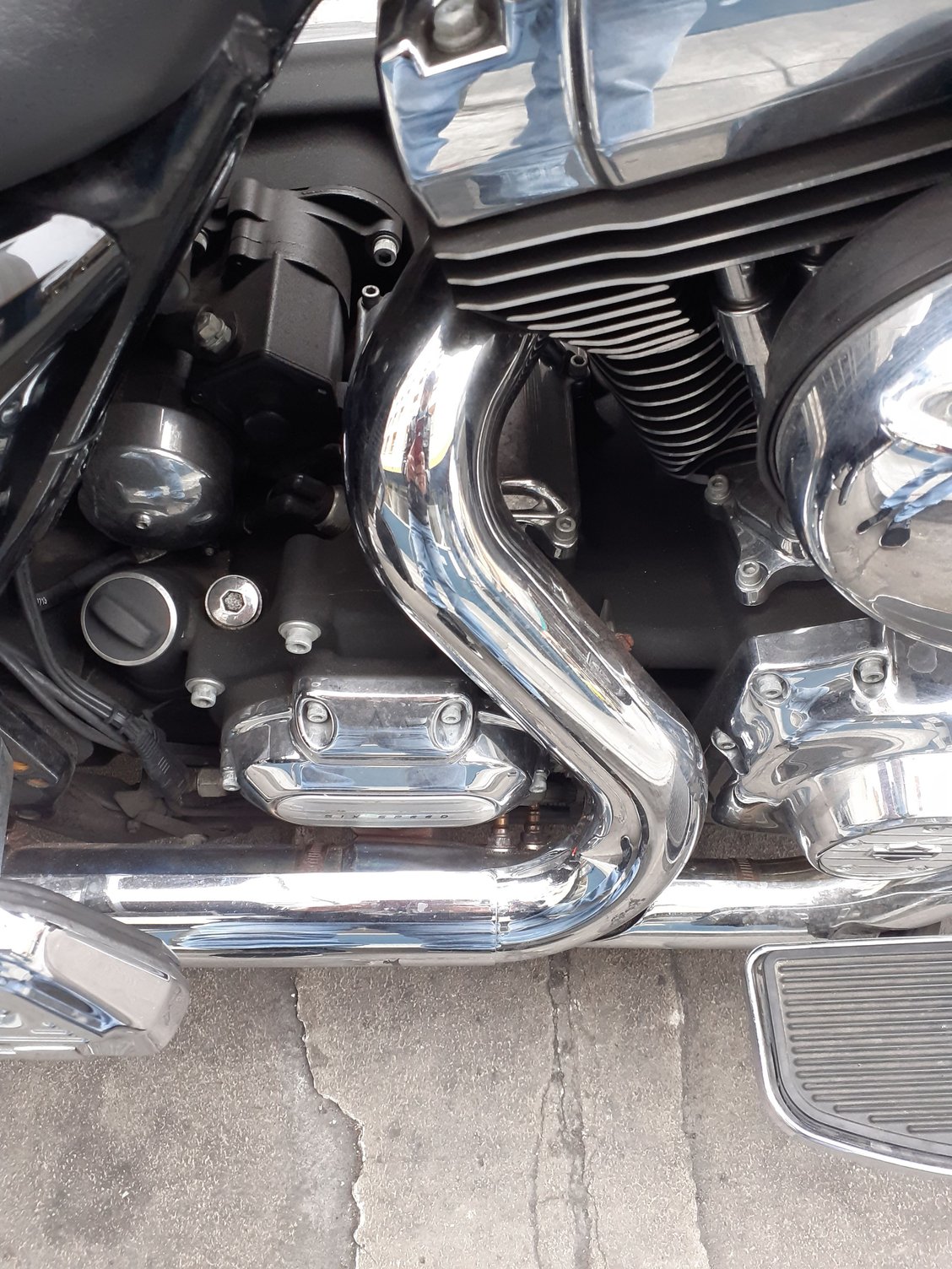

What exactly are you wanting to do here?
Judging from the pic, you may have a Cat in the head pipe, so trying to put a baffle in is not the way to go.

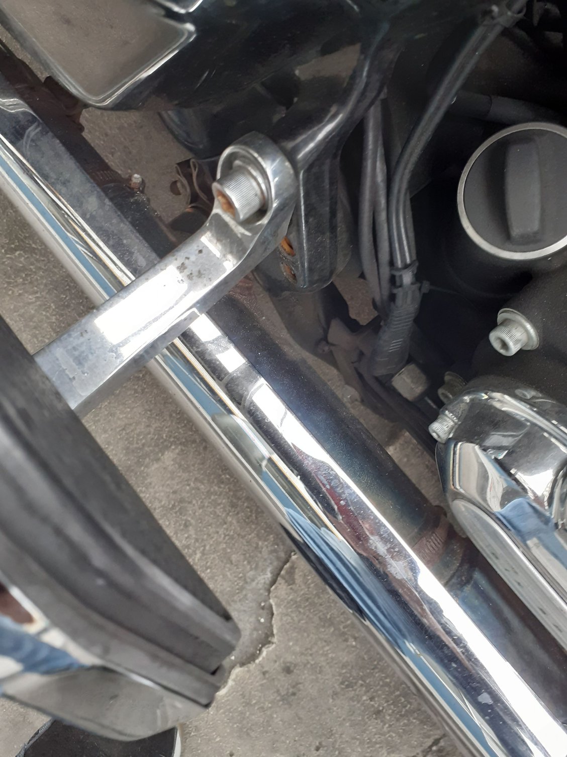

Here is what I have now.

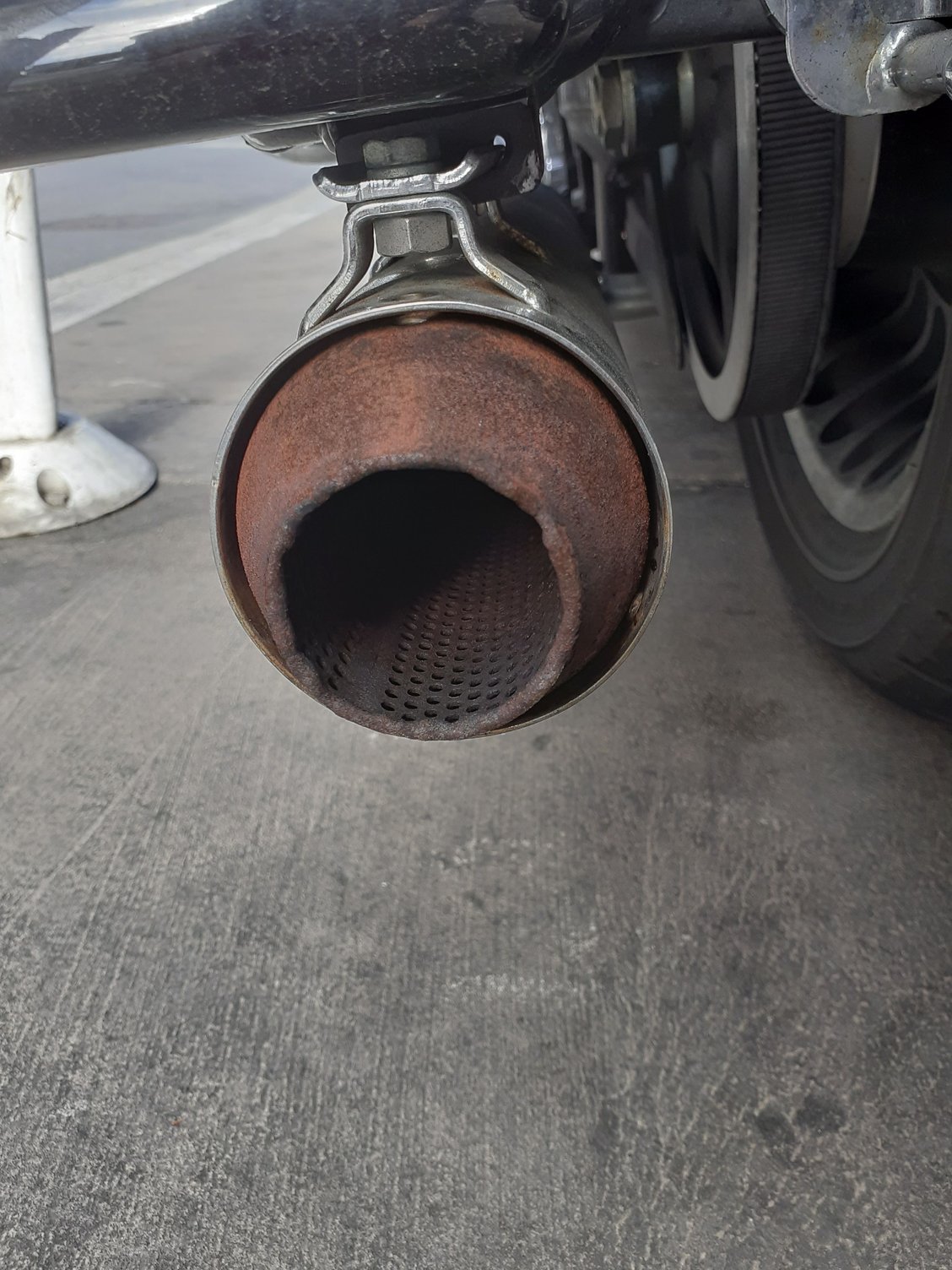

Got the fin off...here's what's inside

So if you want more growl for the exhaust, I'd do with some different slip on mufflers. But California has some requirements based on the CARB standards including a sticker that shows the slip ons are CARB compliant, which includes a limitation on which exhaust will meet the standard.
If you want a rumble at idle and a roar on acceleration, the S&S MK45's are a good option but you need to look around before deciding. Check out the exhaust section here, and Google for sound clips on Youtube of different slip on mufflers that fit your bike. S&S has audio clips of their exhaust included on their site, so check them out. And remember that other components and modifications like a cam, head pipe and air cleaner contribute to the sound (note) of the exhaust, so you will need to hear slip on mufflers on a bike with the same or very similar components as what you have.
