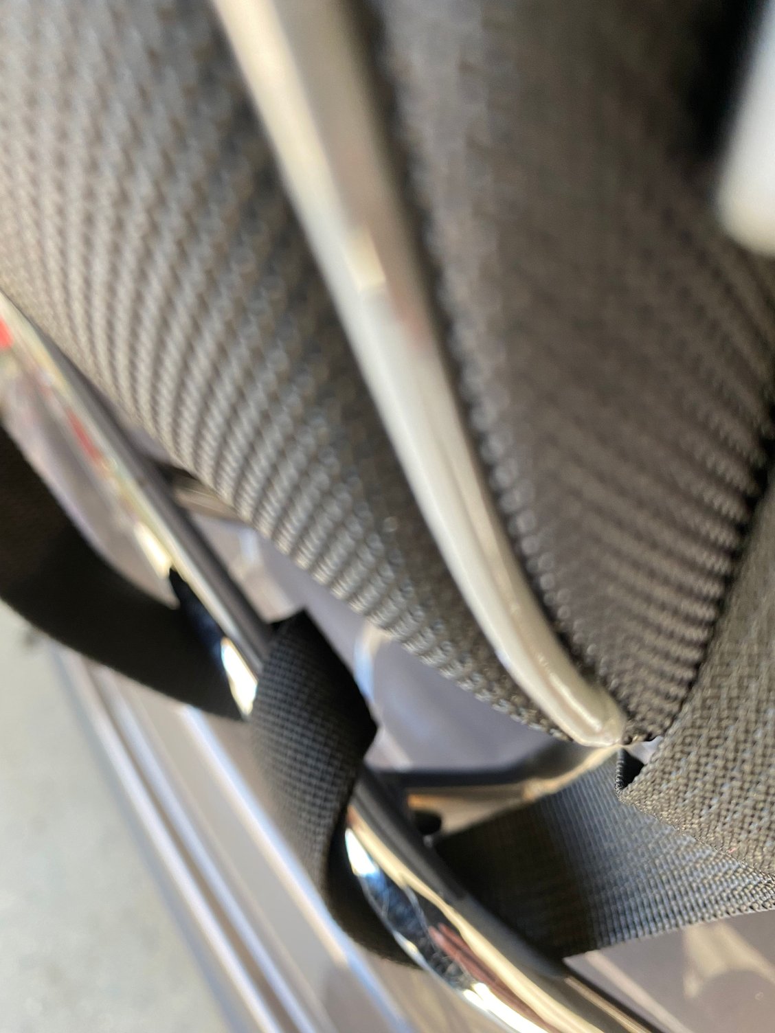

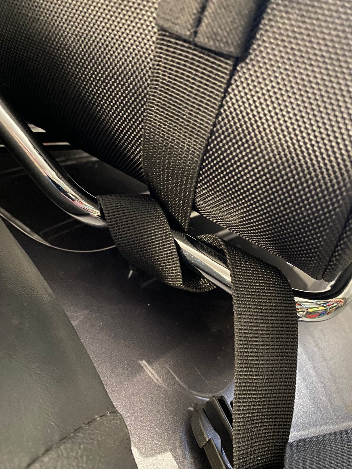

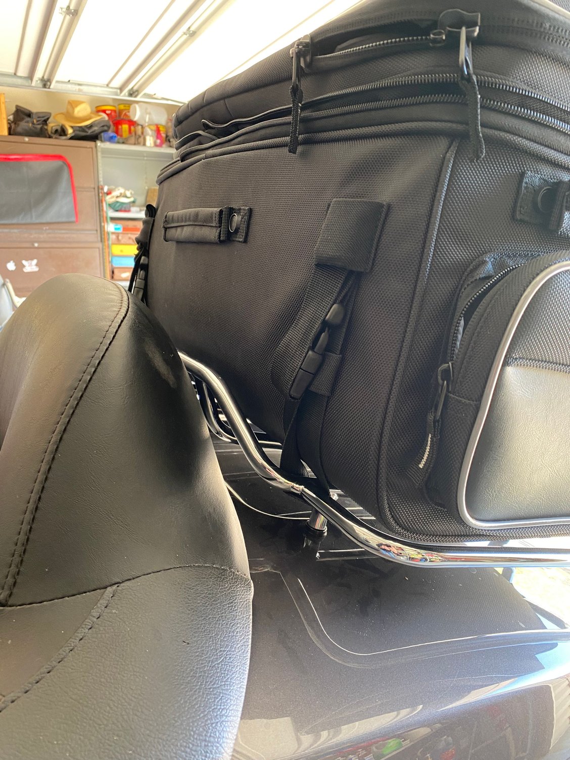

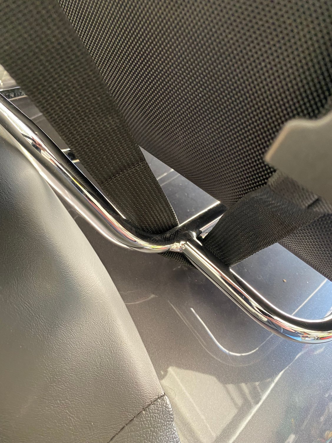

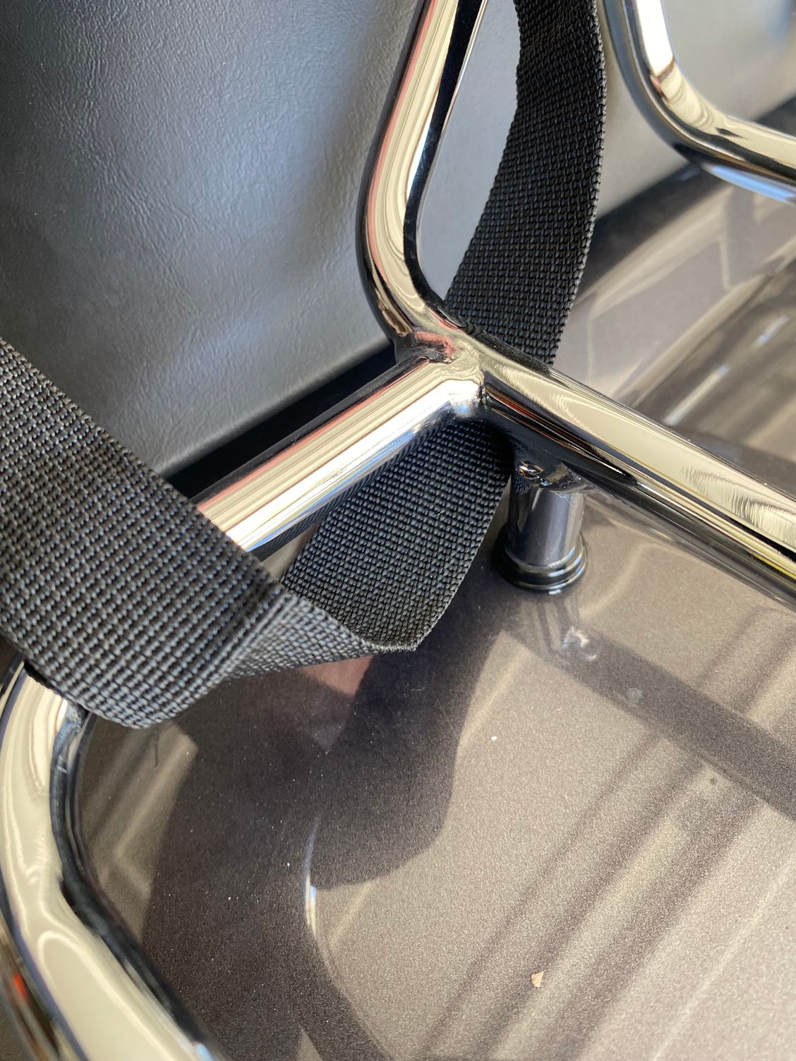

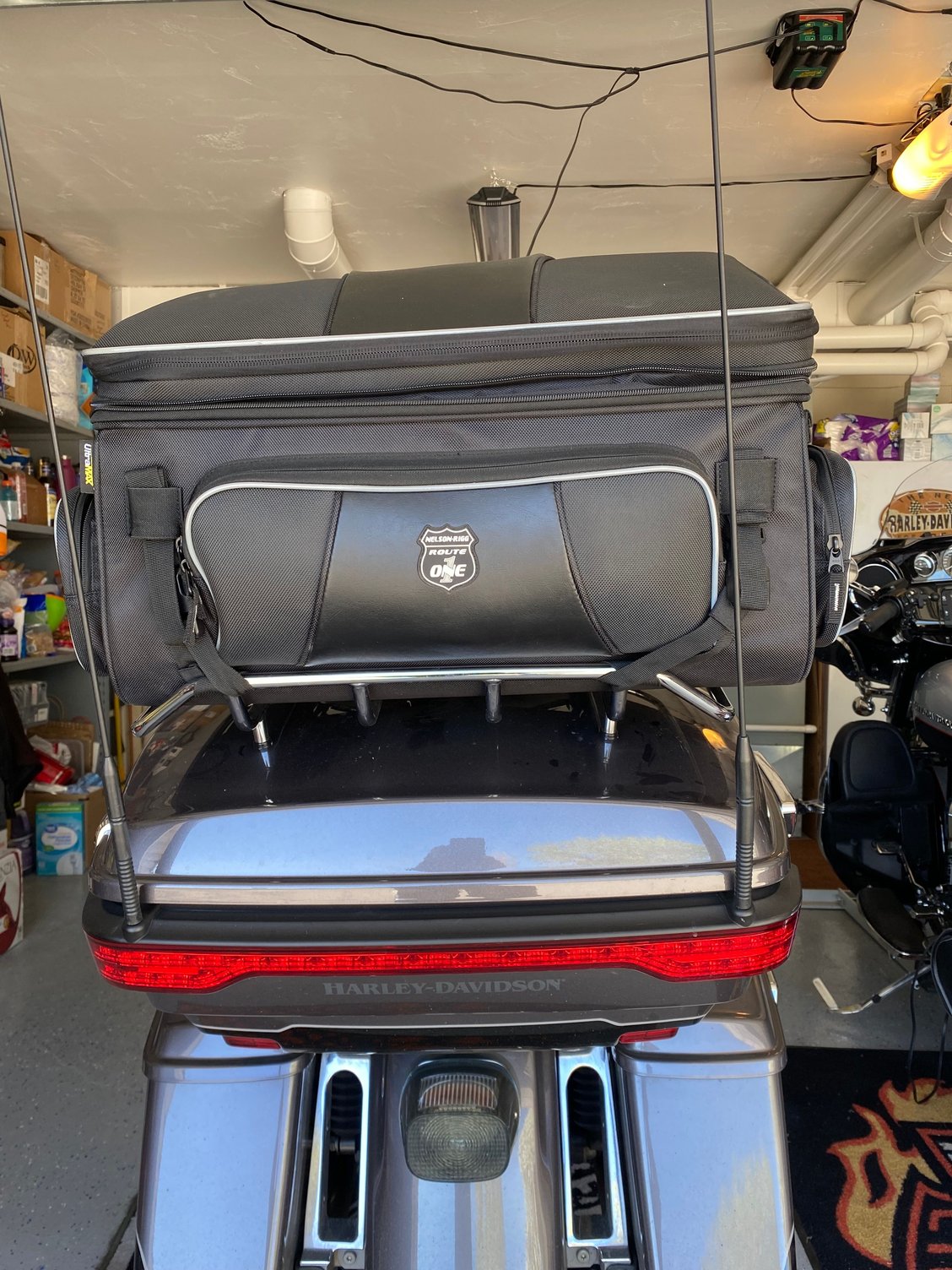

We've been using the Kuryakyn Roll bags on our bikes. My tent didn't fit in it very well so I just picked up a Nelson Riggs bag. Reading your question I thought I'd go put the new bag on to see how it fit.
I hook the back of the bag on first and run the strap behind the post that attaches to the tour pack then loop it once on the back bar. leave the straps loose and do the same on the front. Tighten the straps so the bag is centered side to side and front to back. If you follow what I've done you'll see the bag cannot move or shift in any direction tied down this way.
Be careful, I have pulled D rings off and the swivels through the webbing tightening the straps, as the bags age things weaken, I carry a few extra straps

thanks for the pics. I looked at the NR bag but thought it was a little bigger than I wanted. Was a close choice.
