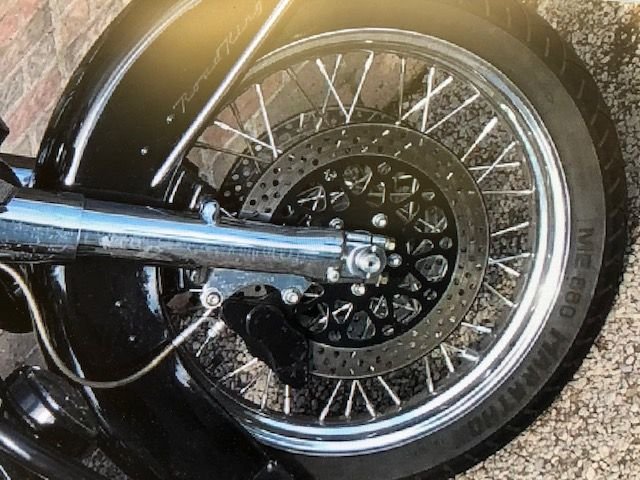

The last time I bought rotors it's been a long time. They tried to sell me new bolts I was going to reuse them. To my surprise when I unboxed the new rotors they came with new bolts. They were HD rotors.
