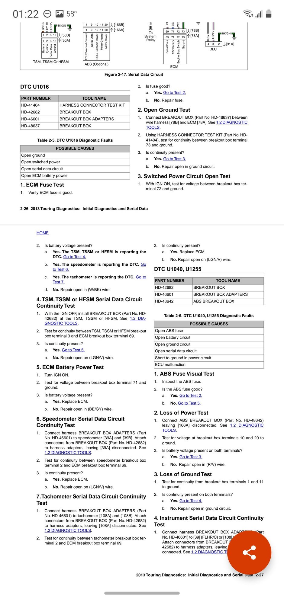

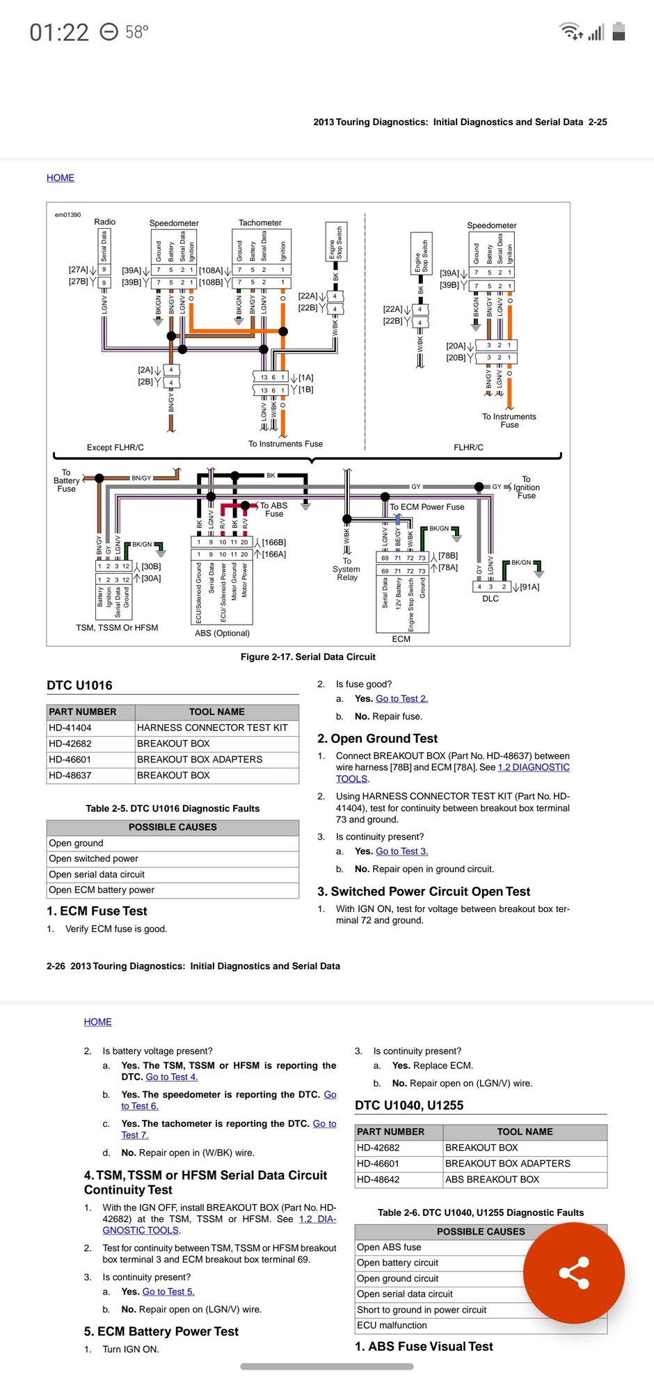

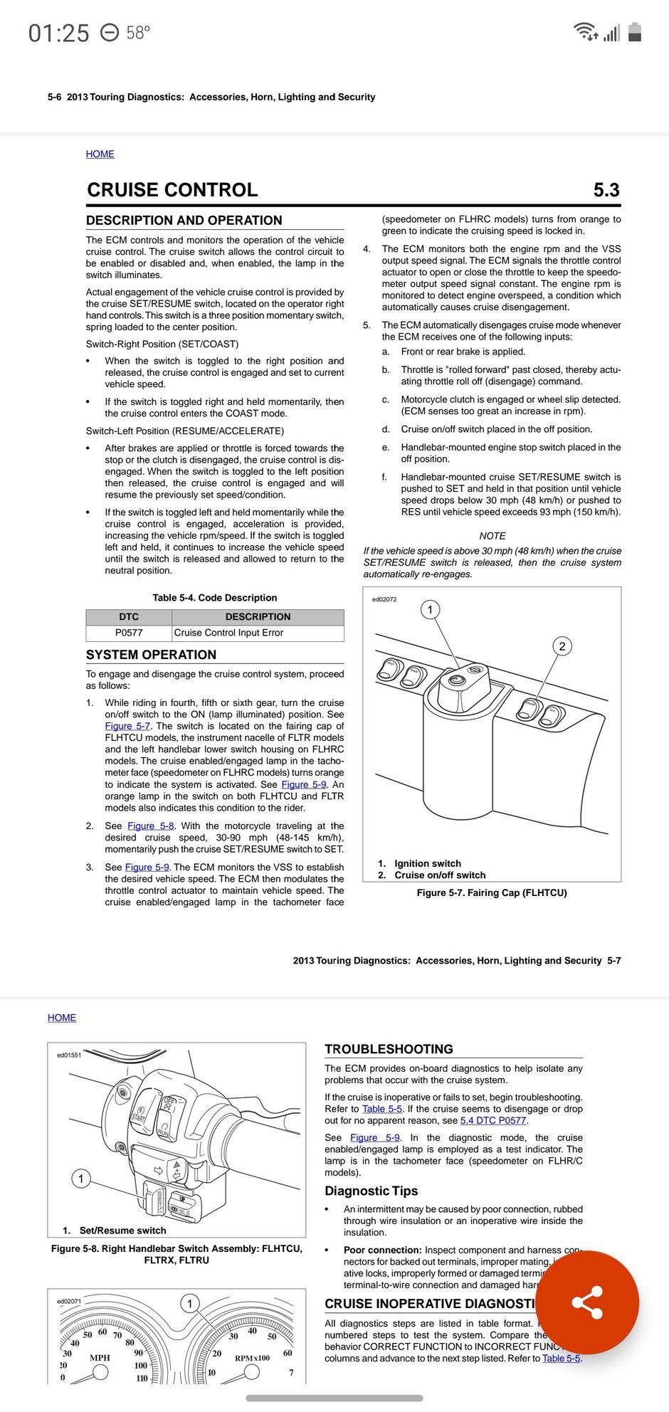

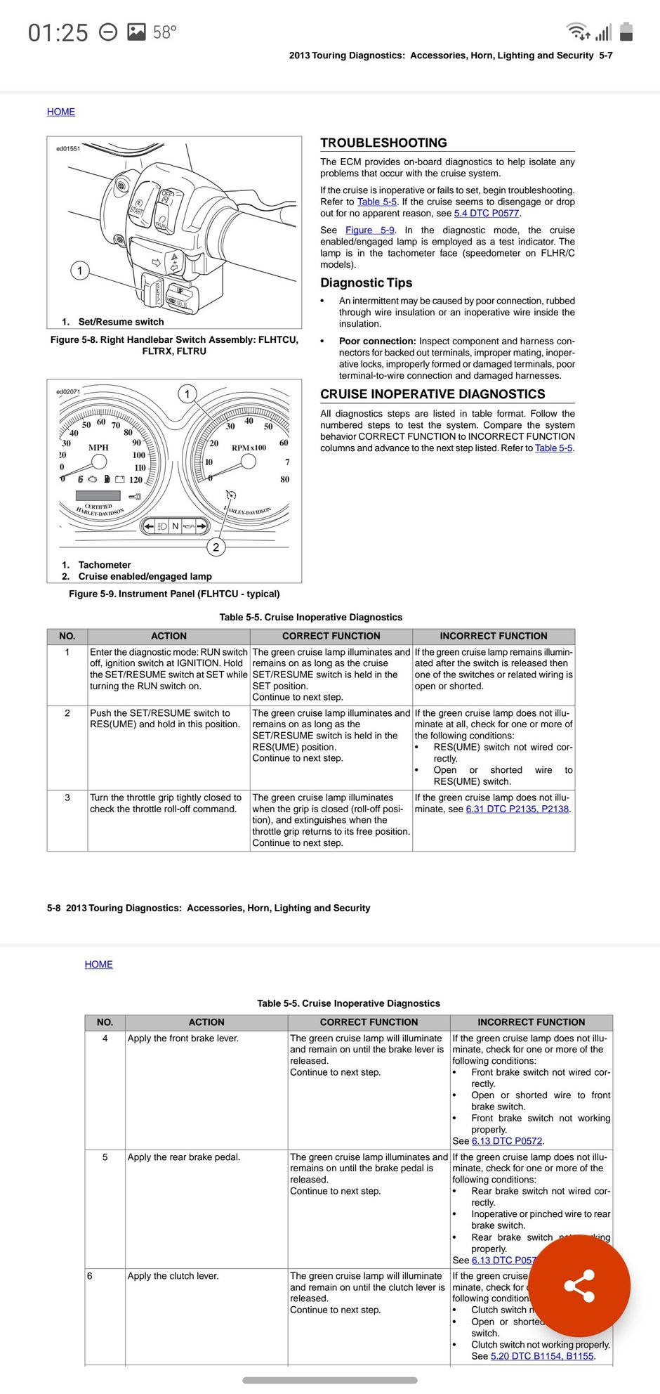

Here are screenshots from the 2013 Electrical Diagnostics Manual. Should be the same for your year. Hope this helps!
