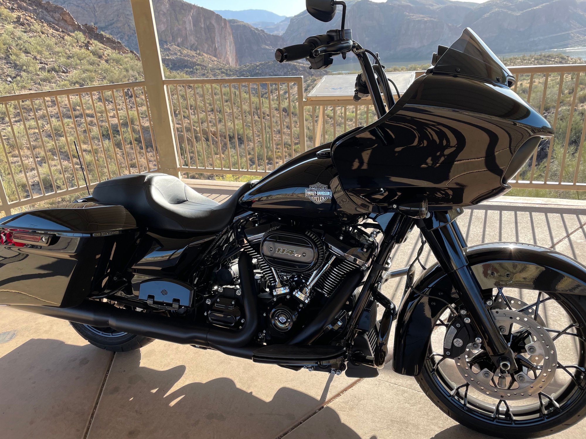

13" road6 customs
Old Jun 9, 2021 | 03:37 PM
oldbie's Avatar
oldbie
Posts: 3,050
Likes: 2,861
From: IL
Originally Posted by fonso003
13" road6 customs
great photo! Where is it?
