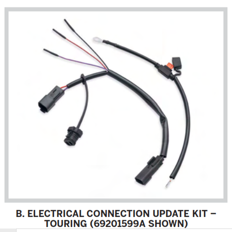

that is connector [4A] "Aux devices" and is a 4 way Molex MX150 connector
if you have the manual, you can find it in the wiring diagram labelled "Main Harness FLH (3 of 3) Touring with Fairing", then go to the index A.2 which lists all the wire harness connectors
I am going off my 2019 Touring Models manual.
