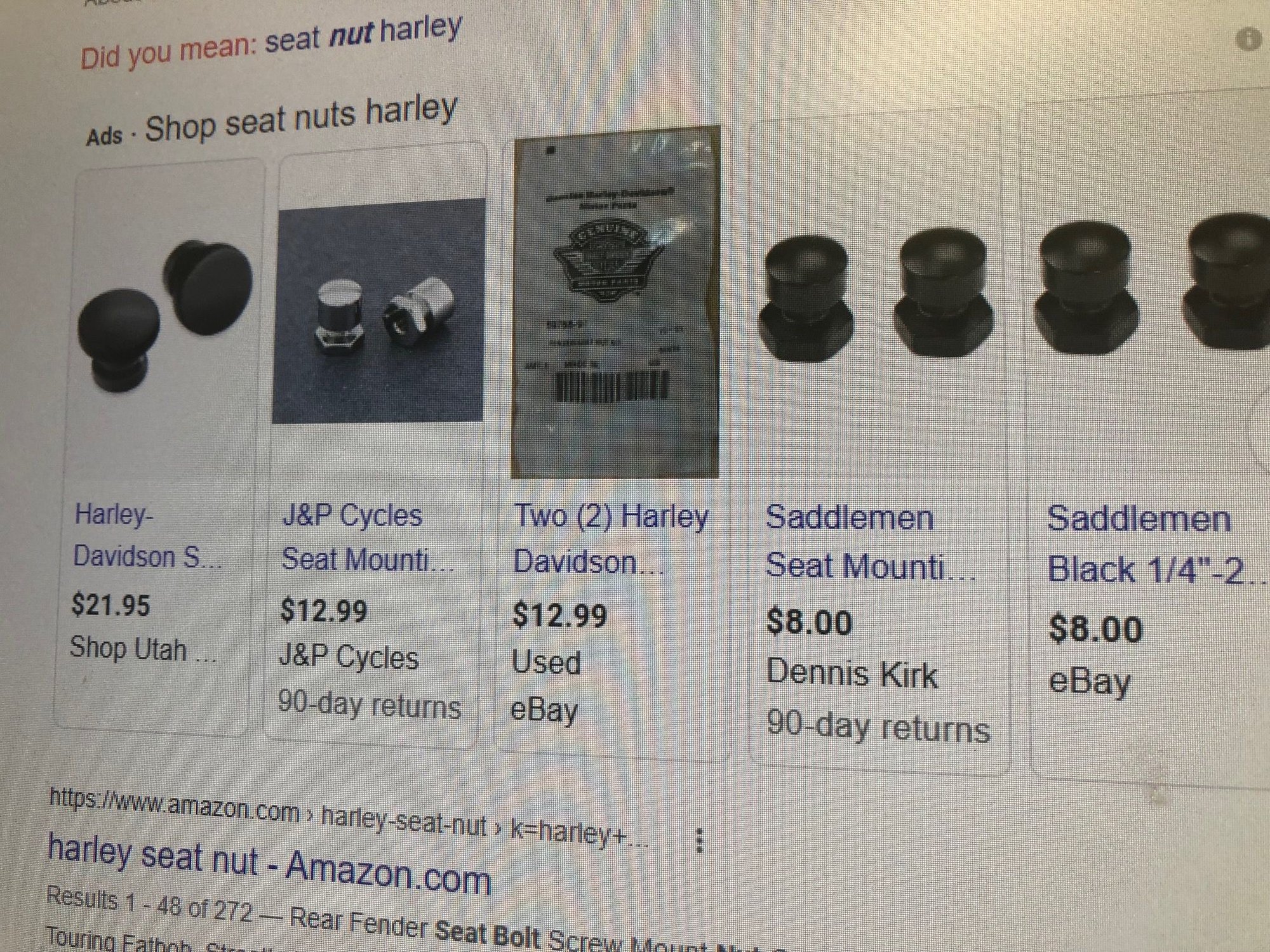

I assume you are actually in search of the special flanged NUTS, not the bolt that`s welded to inside of fender ?
They are used to secure the TWO piece seat used on some models
Google found them in a nano second
Available J&P Cycle / Dennis Kirk and of course AMAZON

found the issue.
My bike is missing a stud plate on the rear fender
