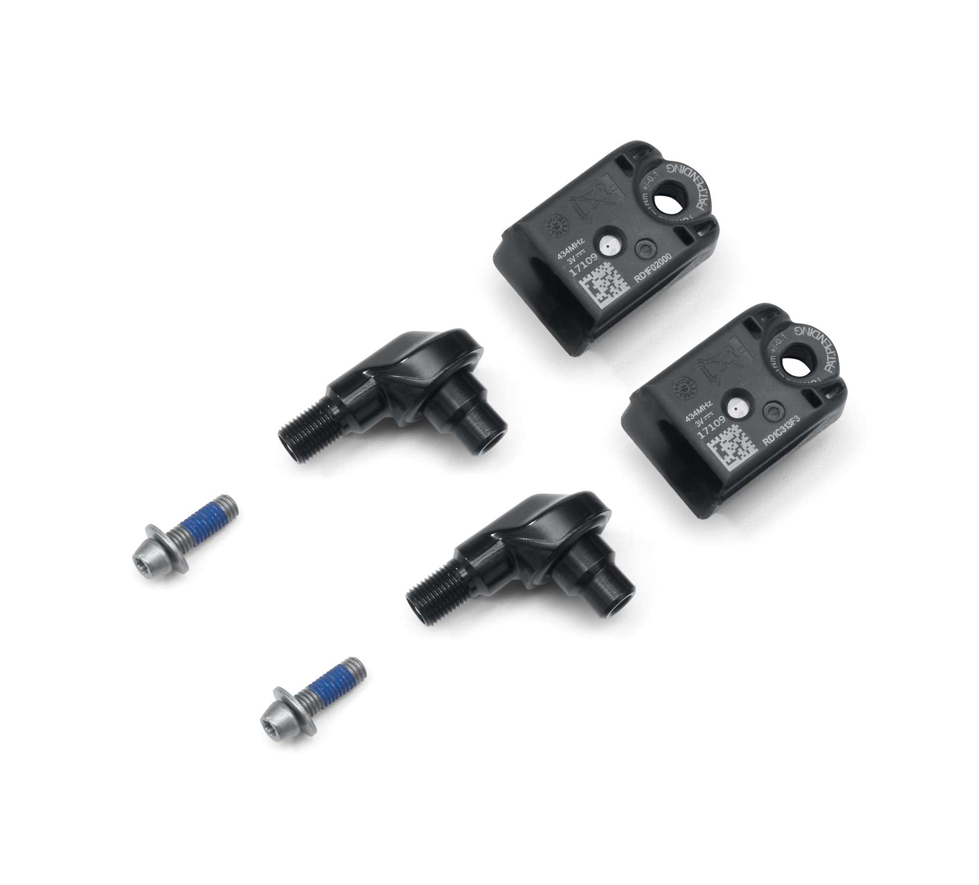

Ok one more question on the TPMS. Looking at one online source for the TPMS sensors, they state the following, "FITMENT: Fits '20-later Touring models (except Japan) equipped with Original Equipment or Accessory wheels that accept a TPMS sensor.". Its the last section I am wondering about.
Will my OEM cast wheels (2104 FLHTCU) accept these sensors? I know about the valve stem sizing issue, is that what they mean, or is there a "spot" for the sensor to bolt to?

There seems to be a few different styles out there, there may even be more that I am not aware of... but I believe they are all for the 8.3mm hole. My bike has the 11.4 hole, and I chose to use these (HD 42300118)... because thats what my dealer had in stock... they're made for the 8.3mm hole, like they all are... that part your wondering about is probably because of the hole size difference, all of the TPMS valve stems on HD site(s) say that.
The newer ones (I think they are newer) are slightly different, notice the shoulder on the stem (HD# 42300124A), that might require a washer (because I don't know if that shoulder will be inside the wheel) on the stem between the sensor and the fobo bushing to put pressure on the bushing, so it lays flat and helps it seal (the sealing part is me over-engineering, because you'll still have the 0-ring on the outside of the wheel under the valve stem, and thats all HD uses).
then there's this style, HD 32700096

Ok, I was concerned there might be a "pocket" in the inside of the rim, that they might be referring to.
