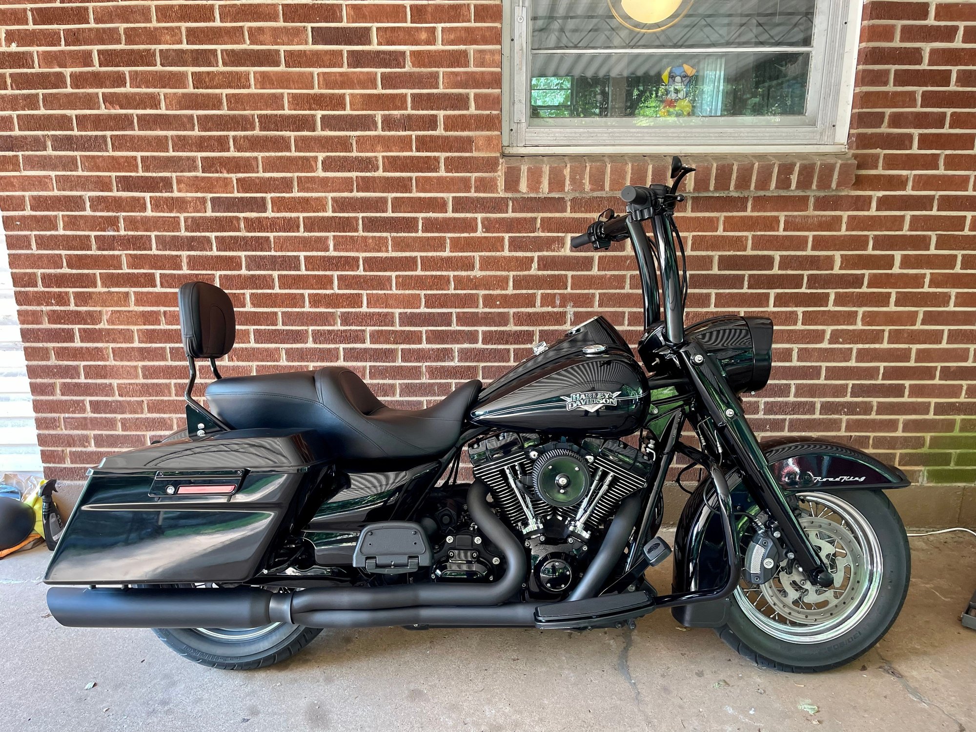

Glad you got it sorted out. How about posting a picture of the bike?

Here’s where we started. Standard Road King Classic.
Here’s a current pic.

Nice job it really looks good.

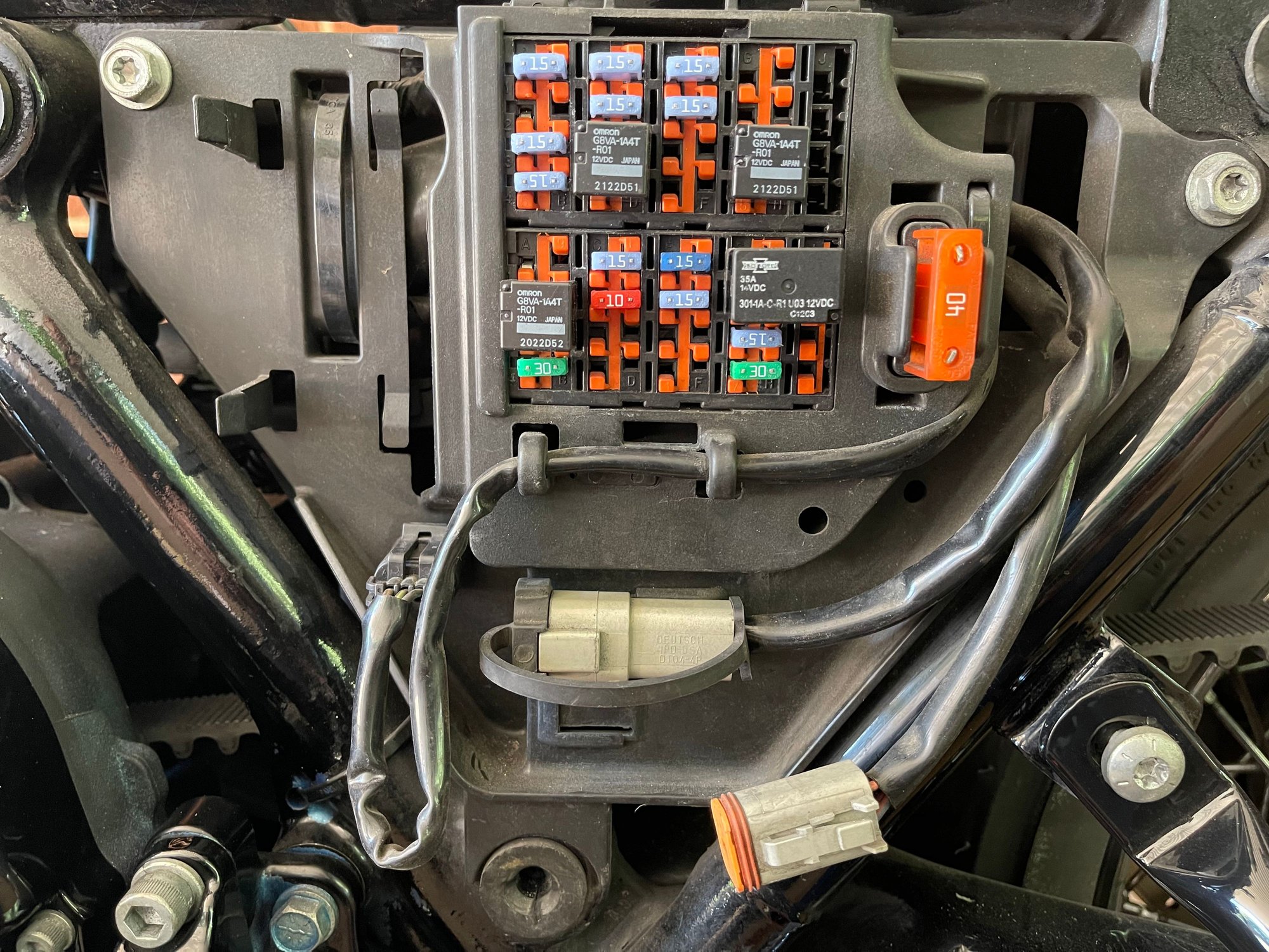

Originally Posted by HunterCustoms
So, this is embarrassing. I think I found my problem. Apparently, the bike didn’t have the ABS Diode Pack installed and I never noticed. 😎
Btw, it’s part # 72547-08
Is the connector you have shown where the diode goes. I have same issue on my 2011 FLHTK.

@TheForceLimited
Yes
