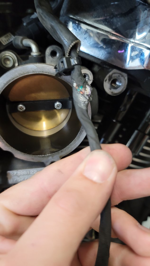

Im speechless. While unplugging my TPS just for fun, I felt that the wiring was caught up behind the air cleaner. Before I even removed the air cleaner I knew what I had done. Ill get them repaired this evening.
Retard of the Year

Hey, that could be your problem.....!
OK, sorry, I couldn't help myself.... but don't go thinking you are retard of the year... anyone who works on their bikes has a similar story... whether they are willing to admit to it is another matter all together... I know I won't... it's that stupid...
Finding the issue is usually the hard part, the rest should be easier...
Good luck with the repair...
