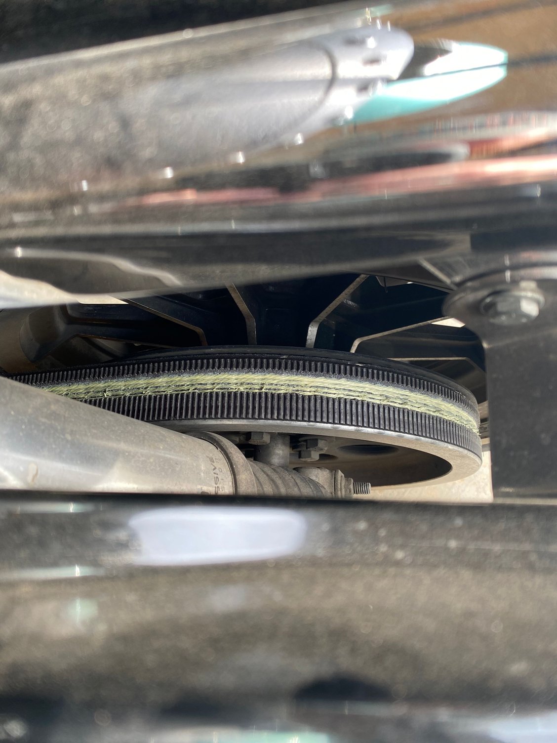

I have a 1997 FLHR Road King with a S&S 113ci and a Baker DD6 trans as far as I know I am running the stock 139-1 1/2in wide belt and I noticed some wear on a ride I took to Pit from Va. Wasent bad made it there and back with not much wear but a bit in the middle of the belt. Then took a 50 mile ride a few days later and developed this haven’t taken the primary off yet but does anyone have any idea whys it’s wearing this fast like this?

Something rubbing it, stone stuck somewhere?

I didn’t see anything but I have time tomorrow and I’m gunna tear it apart I’ll let you know what I find.

Most likely a rock caught up between the front pulley, trans case and inner primary case. You are not the first person to have this happen. I would change that belt as soon as i could.

Should I just say **** it and swap to a chain? I’ve have nothing but problems with these ****in belts!

That happened to me when I took my bike in to the dealer for a warranty replacement of a bad exhaust clamp. They dropped the nut to the clamp between the belt and the primary, test rode the bike and proceeded to tell me it wasn't their fault and I couldn't take the bike until I paid them to replace the belt as it was now unsafe.
Well over $400 and three days over a $5 clamp.

Definitely something in the primary rubbing it. Looks bad.
