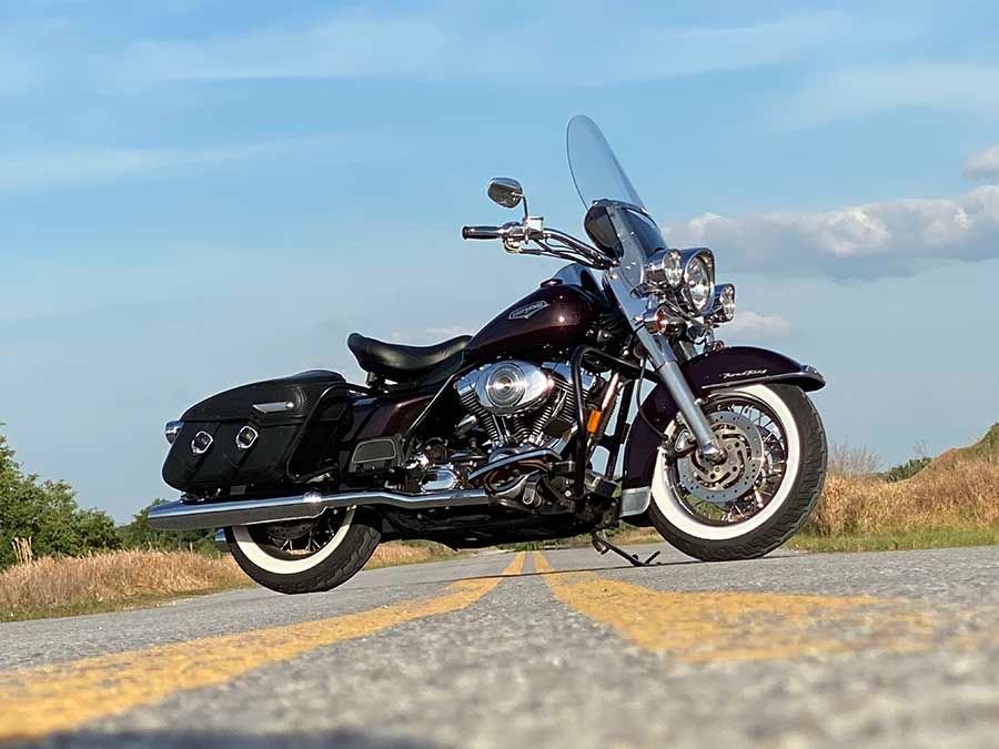

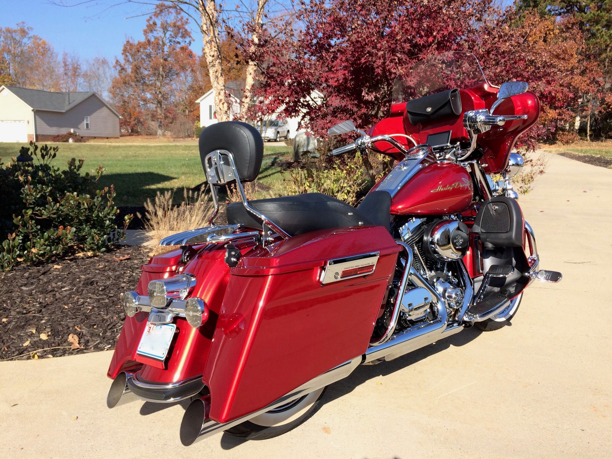

I have one of these on my 06 RKC and I like it. I have an older one that I found on FB marketplace and have installed my own sound system. The amp is mounted under the bottom, with a false floor. I cut the hole in the door for the controller. I know some may not like the "Bubba-ish" way I figured out how to do a quick disconnect for power, but it works. I used a 4-plug trailer connection mounted under the chrome on the nacelle. It takes all of a minute to remove the fairing and all the connections are through one connector (ground, power, ignition (triggered) power, and also another wire if I should ever hook up the blue (power) wire for another amp or something elsewhere on the bike. I like it, and as you said, I can switch back to the full windshield, or no windshield, in seconds.
With the batwing fairing.
And, with the windshield.

Only pictures I see are with no fairing.
