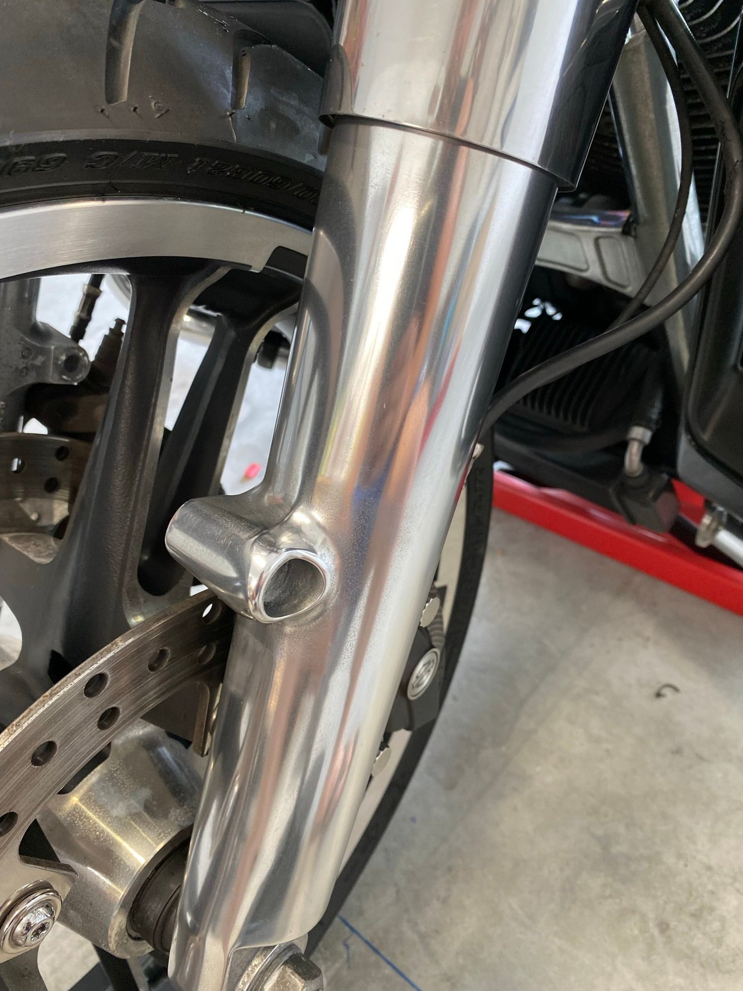

How do I make this look like new again.

On lower fork sliders I have removed the clear coat and polished off the brushed look and further polished to a shine. No form of white worm corrosion has formed on the bare alloy.

My front forks looked just like that. As a previous person suggested wet sanding starting at 400 and working my way up. I actually went to 3000 grit. Then used some polish,

I sanded my forks, started with 220 and got to 2000 paper then buffed with a mid grade water based (mira grade 12) automotive compound on a drill with a black 3" pad and it got me a finish I was happy with, it took me 90 minutes a side to go from corroded to flawless
On the wheels I cleaned them as best I could with soap and water, then hit them with the compound on a pad, and they cleaned up nicely
The compound did an exceptional job on chrome too, the wheels on my 13 came out as good as new
a bottle of Mira 12 is a lot cheaper than semichrome or other polishes
I tried looking for this stuff and came up with a stainless steel water bottle and a vacuum. Do you have a link for Mira 12? I want to give it a try.

My bad, typo it is Mirka.
https://mirka-online.com/pc12-1l-mir...medium-1l.html
I have used it on black bikes and tanks and with the right pads ( I like black foam myself) it leaves a near perfect swirl free finish, It was only by luck I tried it on chrome because I didn't have any chrome or aluminum polish on the bench. It wasn't until I detailed the red 13 with it while it was on the lift while I was repairing the front head that I tried it on the forks on the 03.... if you have worked with enough scratched metal, you find after a while that with the right sandpaper, scotchbrite, or fine enough abrasive compound you can fix or almost hide 99% of flaws.
I do a lot of paint correction for my friends, I go thru 2000 wet paper like TP some weeks, and my buffers rarely get put away
As I said above, if you work in one direction once you get into the finer grits and IIRC in my case most of mine was done in strips around the fork not up and down in order to go with the existing machining marks you can with enough patience and elbow grease get a really nice shine out of the forks once the clear has been removed.... and to remove the clear you can sand in any direction as any marks you leave will be removed by your next finer grits.
It is near impossible to screw it up, because all you have to do is keep sanding and polishing, aluminum is very forgiving
PS in a pinch the even finer #10 or even #8 would work too
