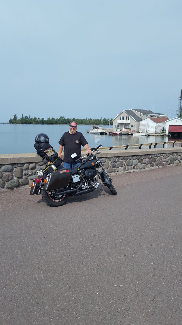

Ive had 4, 5 and 6 speeds. Just this summer rode my Shovel 4 speed around lake Michigan. Tried to keep it under 65 going up east side but coming down west side I was over 70 just to keep up with Milwaukee and Chicago traffic. 3500 RPM is enough on a 4 speed shovel with no rubber mounts. I like my 6 speed and my son liked it so much he had installed the 6 speed in his 5 speed gearbox. He on his '03 Glide and me on my '13 use 6th gear all the time. As for me anything over 30 or 40 works for 6th.
Bottom line is even a 40 year old shovel 4 speed will get you there..... In this case Copper Harbor Mi

Is that a Sturgis I see? My buddy Harold had one back in the late 80s, and it was a sweet, but troublesome, ride.
