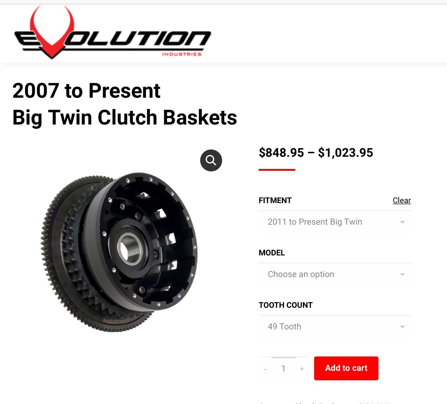

I don’t think a new compensator or clutch plates will give more seat of the pant. Replacing the the stock 46;tooth clutch basket with an Evo industries 49 tooth will. Just my opinion, but your Feuling cam isn’t much different than the stock cam it replaced. I’d try aN Andrews 48 before any other mods.
