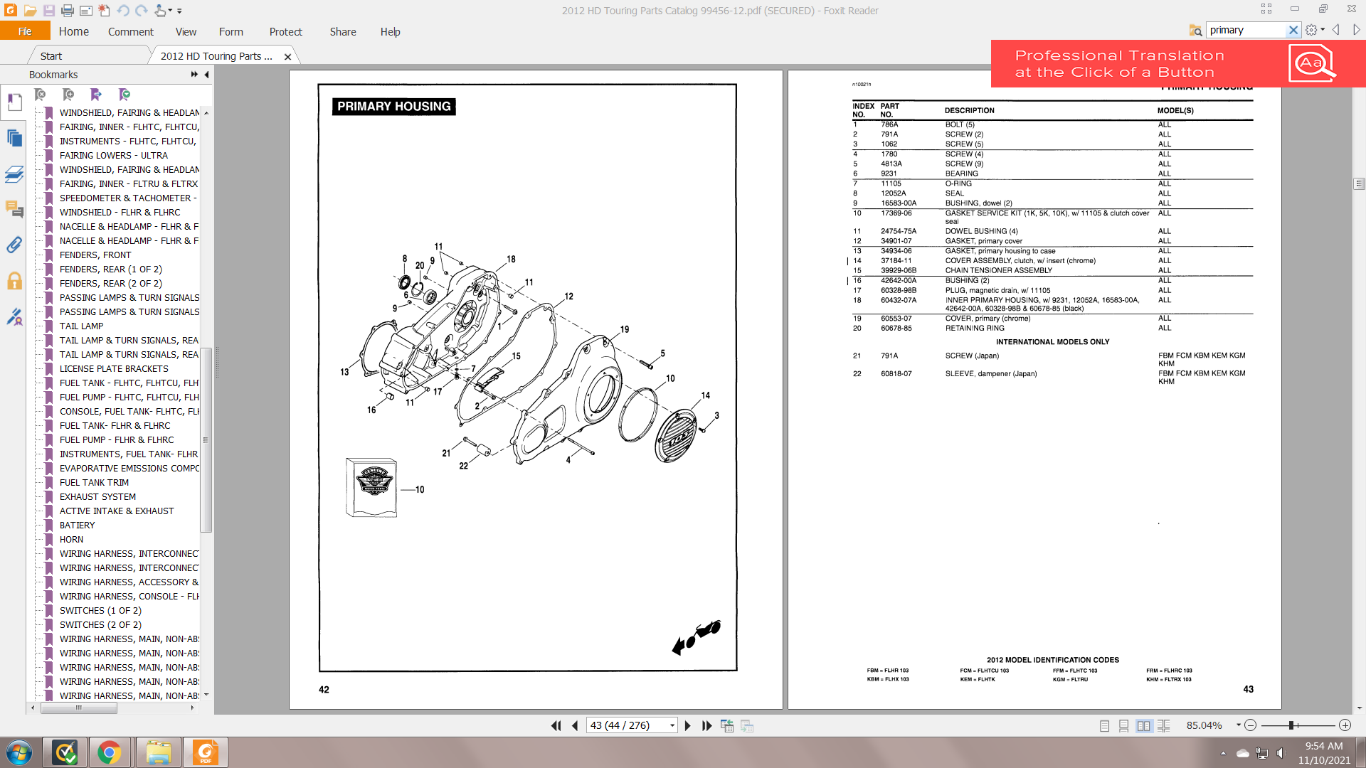

OEM parts listing ... A chrome inner may be available from the accessory catalog ... Many aftermarket inners are poor chrome ... Good Luck

https://www.wilkinsharley.com/fckima...21-Catalog.pdf

"I have the 2012 Parts catalog double check part # to 60739-07 and it is the correct inner primary part # " ... Curiosity, the picture I posted ( reply #2 ) is from the 2012 HD Parts catalog and it doesn't show this number unless I've missed something ?? ...
@hdman6
The H-D P&A book has a separate section for Engine Trim.
