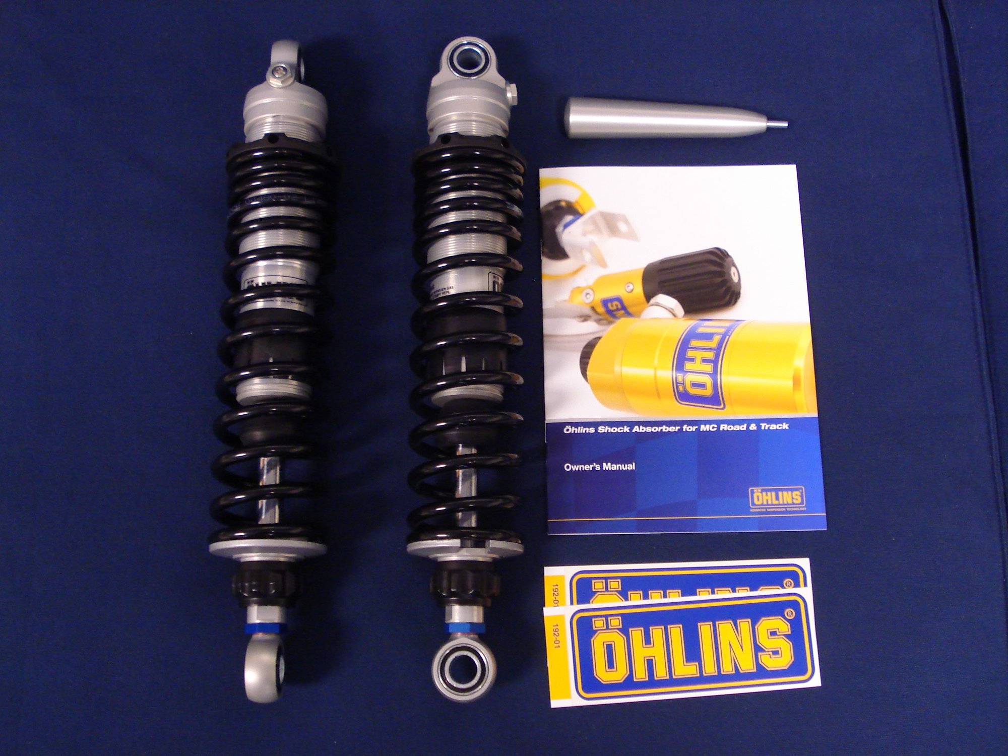

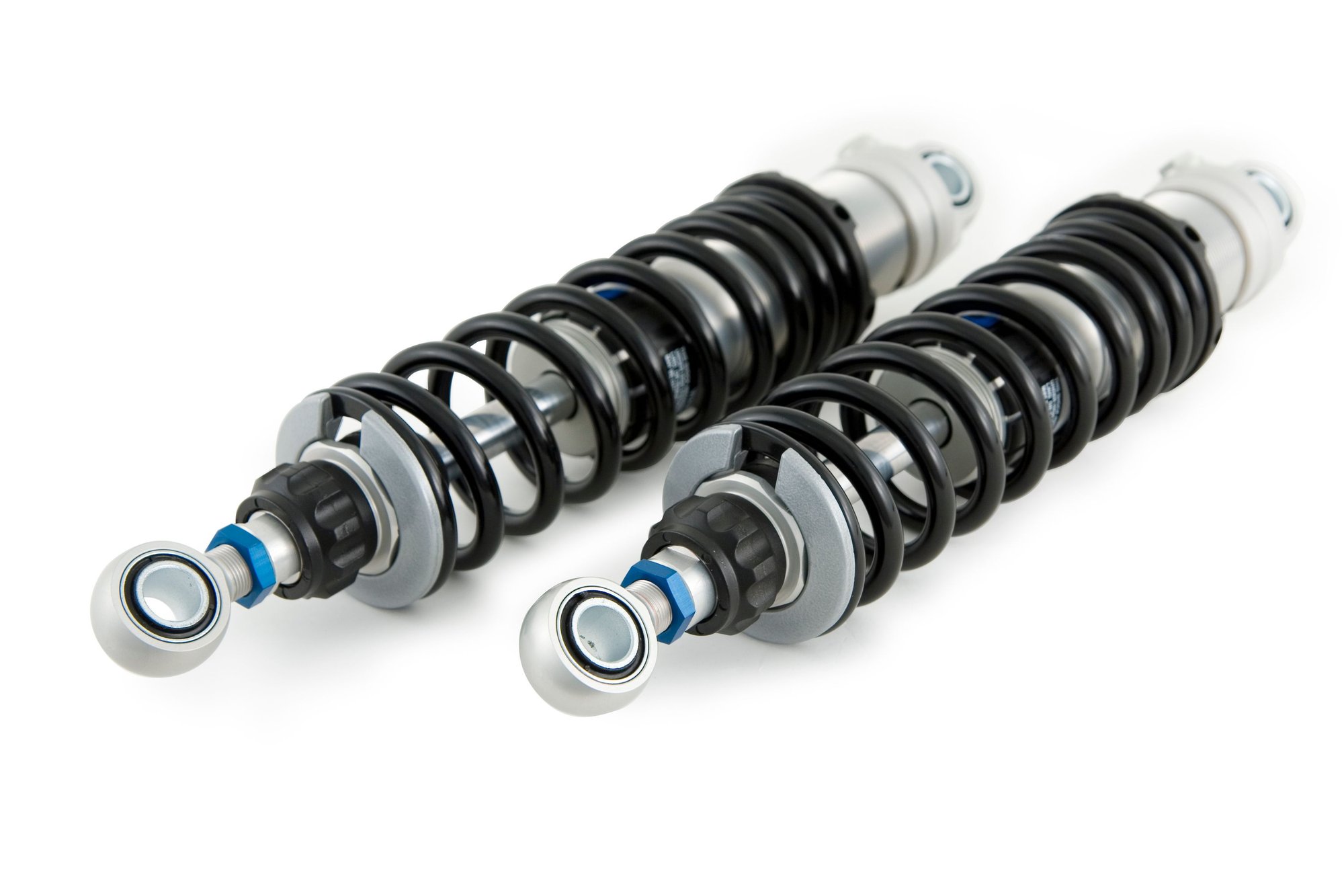

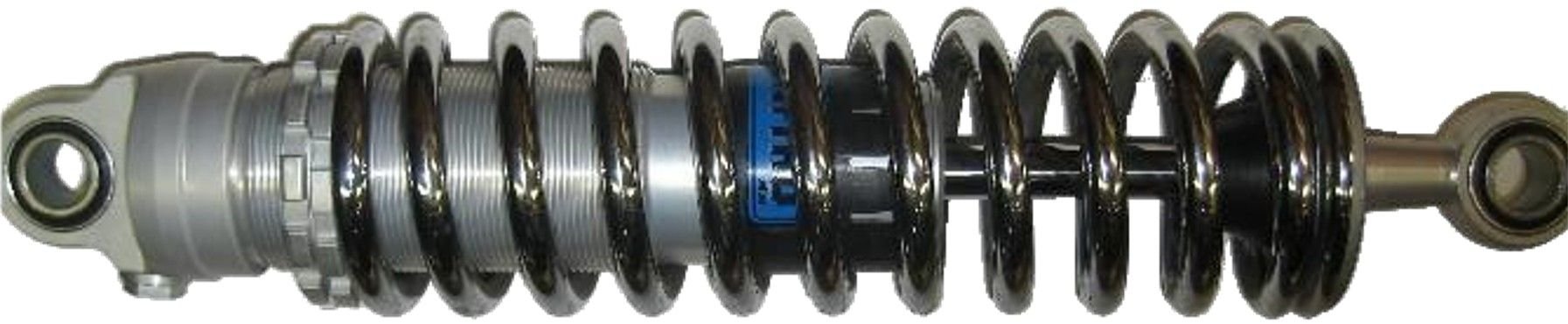

A 777 is an emulsified shock and a 772 is a separated shock with adjustable external adjustment & a height adjuster(s). Price difference is around $250.00 +/-. I have included several pictures of a HD 157 which is the exact same shock as the HD 772 except in black and the last is a picture of an emulsified that has no separator piston, no adjustable compression & rebound ability and no height adjuster. Any further information can be had by going to my site & looking on my link(s) "How they work" and Shock Pre-Purchase Considerations.

Howard’s website has a lot of great information on shocks.I have factory air shocks and there’s a cut away of one and it looks pathetic. I need to look into some rear shocks before spring.
