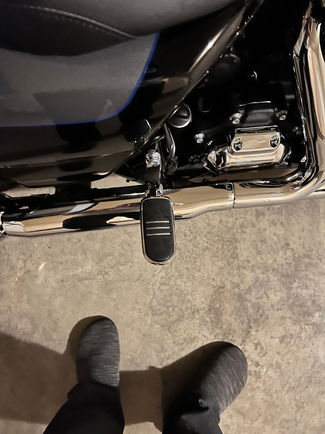

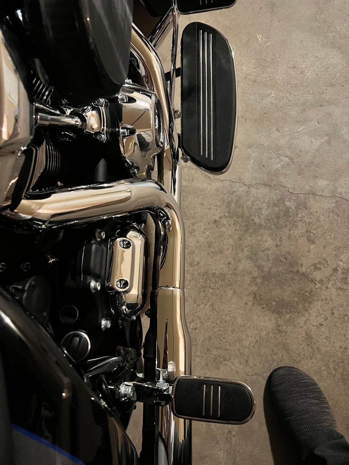

Hello, just bought a 2021 street glide special and I have a question about a passenger footboard. I'm wanting to buy the Willie G footboards for my wife but I currently have the stock foot pedal. It isn't a peg, but more like a pedal. I will attach a photo. I've looked online everywhere and can't locate exactly what part number I need to install the Willie G footboard insert onto a footboard. I understand I will also need to buy an attachment also. Any help would be greatly appreciated.

Those are the stock passenger pegs, not pedals
So, you are going to have different inserts on passenger floorboards than the rider boards? Here is a link the othe Willie G inserts. https://www.surdyke.com/PartsMain.as...otboard%20Kits

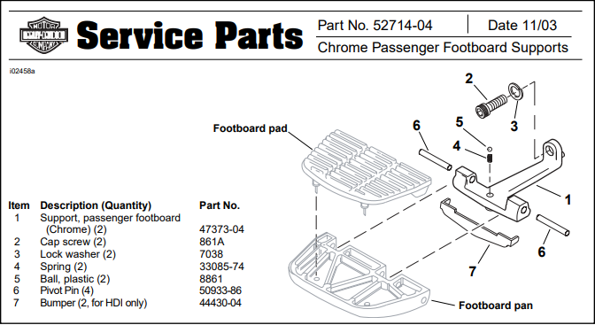

Hope this helps. The ***** G. parts are just inserts as far as I can tell.

You're gonna need footboards pans, mounting bracket...
Footboard Support like #50500042 $112 (Add $30 or so for Chrome)
Then footboard "Pans" in the correct style to fit your inserts ("contemporary" or "classic" or whatever)

If I'm not mistake, those are streamliner floorboards and passenger pegs, pretty sure all SG's come with passenger pegs and not boards. you may have to buy passenger floorboards and add the ***** G inserts.
rk classic.
Yes it looks like the rider boards are streamliner, wondering what pans I need and any other attachments to add boards and the willie g inserts for my wife. Thanks

You'll need the footboard support kit and the footboard. Then get the footboard insert.
Part numbers are support kit, Willie G insert, then the std passenger footboard. The Willie G cover is 50836-07. The Willie G cover goes under the footboard pan, so when it's flipped up, the Willie G skull is visible.
