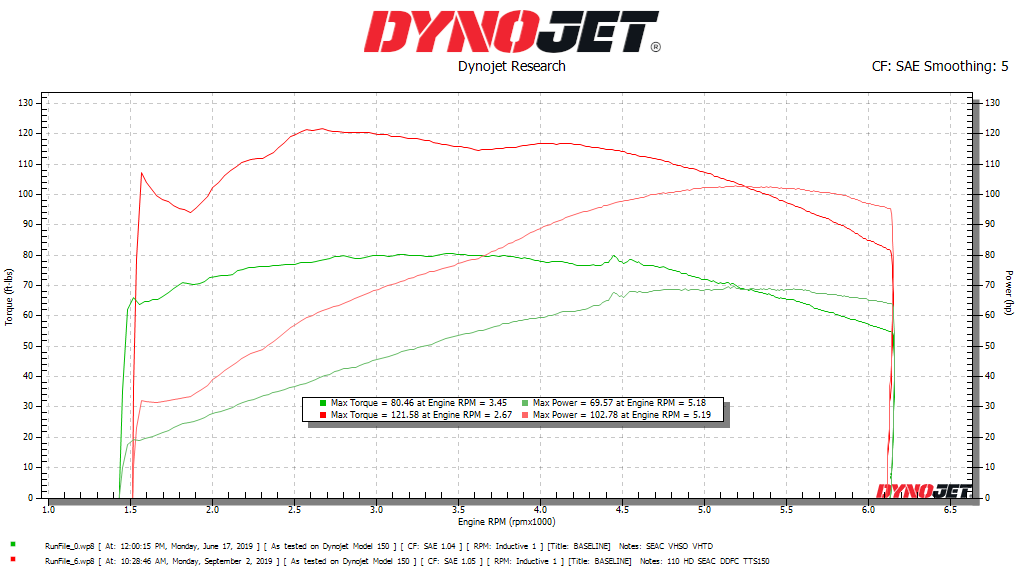

A drop on 110 kit with your stock heads can make a tremendous difference without having crazy compression. This is my buddy Jeff's bike- he had a stock 96 with SEAC and V&H headpipe and V&H mufflers. He added the HD 110 cylinders/pistons, TTS150 cams & tuner, and a D&D 2-1 pipe. He ended up @ 10.1:1 static compression, and put 20K+ on the build since September of 2019. We did machine his heads for, and added, the ACRs and harness, to prevent starting issues.
