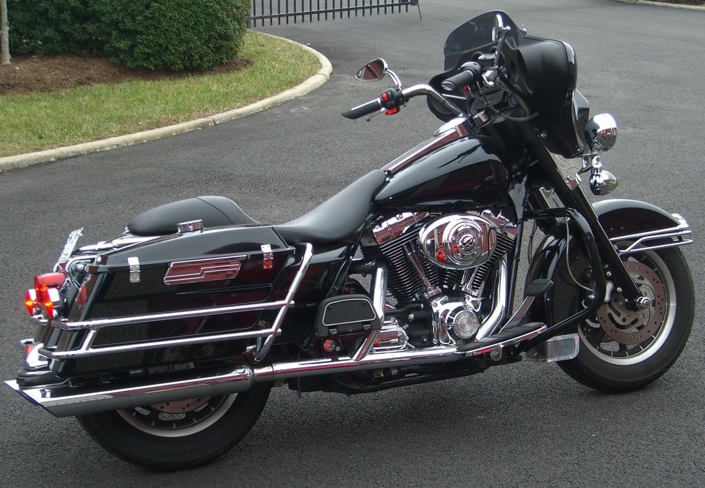

Good morning, this is my 1st post in this section.
An Army buddy has offered me his ‘04 EG police model. I was with him when he bought it used from Quantico HD over a decade ago and I trust him completely, but coming from an Evo Bad Boy springer, I know jack about TC88s and touring models. My main concern is being too invested financially, as I keep reading horror stories about cam chain issues. It’s got about 42k miles and I think he wants about $4k. It’s very clean. Local Indy shop near him wants $1200 minimum to address just the tensioners. Thoughts? And thank you for any feedback.
PS: Its has been dechromed since I took that photo.
Scott in TN

Looking at the pic and not knowing much else, I'd say it be worth looking into and would be worth the time to address the tensioners. You don't necessarily need new cams, but you're in the range to look at changing the tensioners. That's not a bad price to get into, what looks like from the outside, a bad bike.
