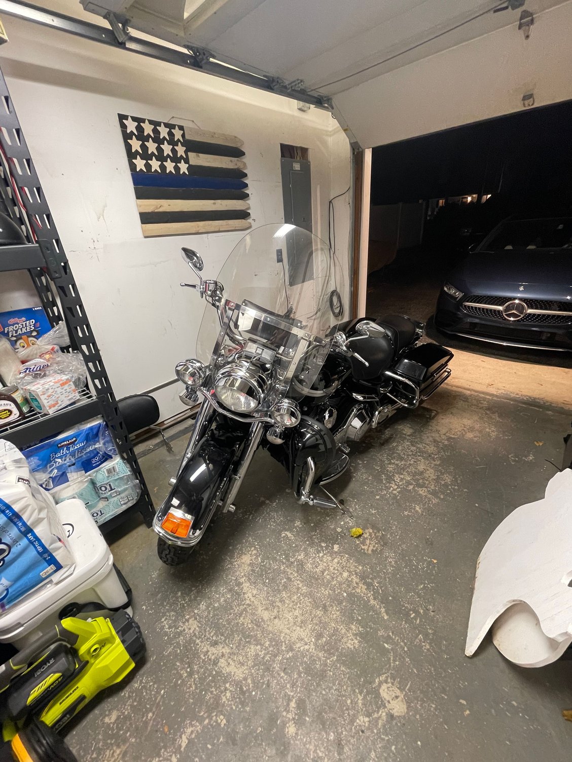

I recently purchased a 2003 Road King. I’m trying to find out what max height handlebars I can do without having to change any of the cables. They sit way too low for me. Any advice would be great. Thank you
