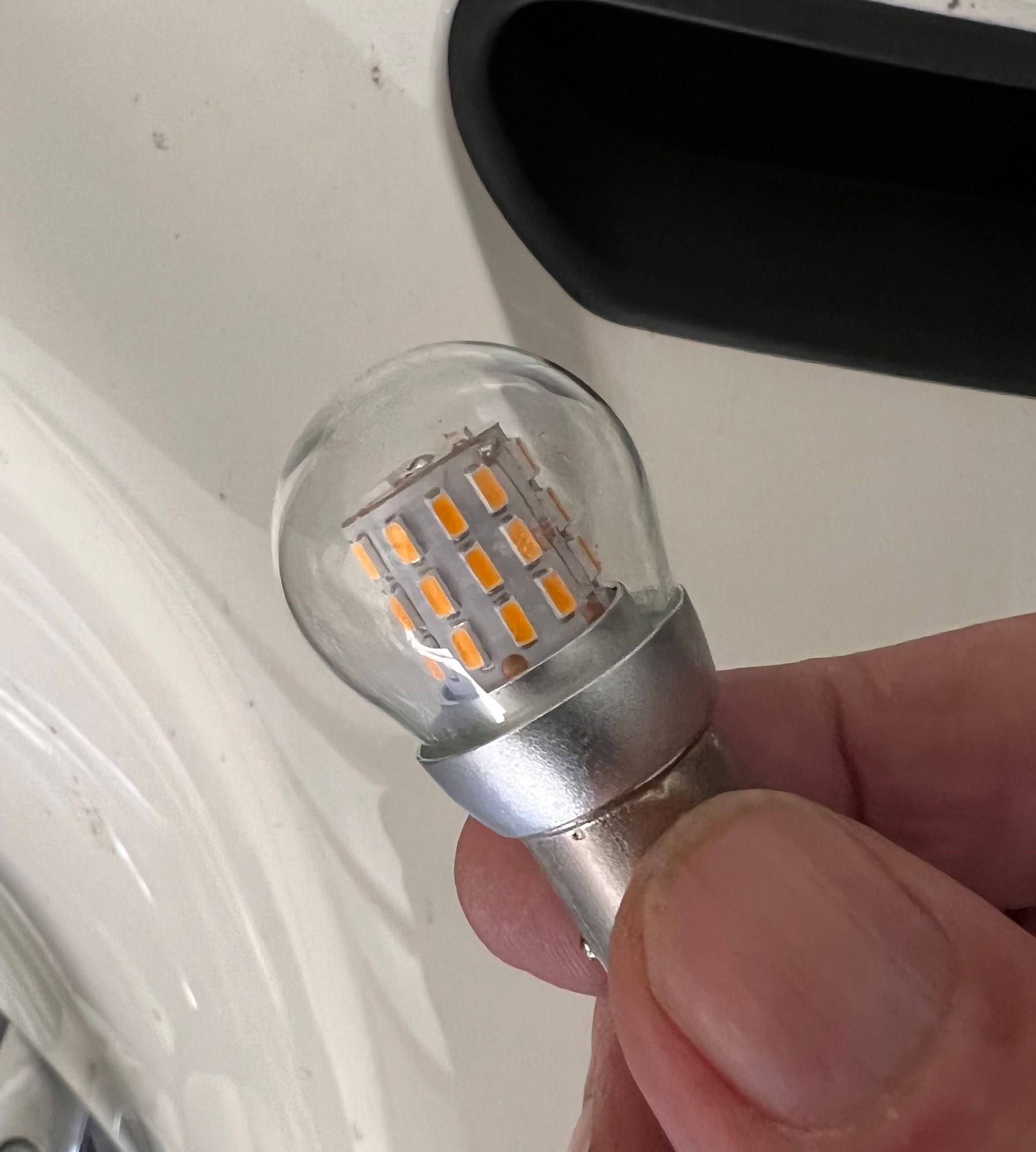

A bit late to the show, but I found these to work well once they were fitted:
Alopee 1157 Amber
The aluminum ring at the bottom of the glass had just enough swell to prevent the bulb from seating fully. A few minutes with a hobby file took off enough material to fit and lock in place.
The result is having a light much brighter than stock while retaining an essentially stock appearance. Important with keeping the ‘look’ of my Revival.
Yes, dirty in those pics… It is my daily ride!
