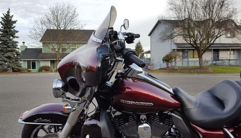

Originally Posted by NoRegerts
The Klock Werks website says to sit on the bike and the top of the windshield should be even with your mustache. Between you upper lip and nose. You look over it so it doesn't impede your view but reduces wind and eliminates buffeting. The only time I get buffeting anymore is in a strong crosswind.
There are many options. The lip at the top is the key to having the effect of a taller windshield at a lower overall height.
I agree, with that, but can I add, something to this? I find sitting on the bike in the garage is different then riding, I find Im sitting lower while riding, I propped my bike up with 2x4`s to some what level. set on the bike in my riding position, Held a string at the top lip with a string level on it while my wife held the other end. once level, she measure to the screws on the windshield. To get my windshield height. But then again I am OCD.
