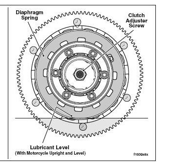

I installed the extra disk clutch and a new spring. Obviously the clutch is hydraulic so there’s no cable adjusting. I tightened the 6 clutch bolts to 95 inch pounds. The bike is creeping badly and i can’t find neutral. ??? what can/do i do?? i was told to back off on the clutch bolts and should fix my problem but i don’t know. what inch pounds should i adjust to

Are you sure you got all the original plates and spacers out? I ask, because it happened to me on my Tc. But, I’m a dumb ***.

yes got all out but with the derby cover off when i pull in the clutch looks like the bottom edge moves and the top doesn’t may just be my perspective.

Remove the damper spring and seat?
Probably needs bled. I also read of a trick to tie your lever back far as it goes and leave it over night. Allowing the air to travel to the reservoir and escape when released.

This:
