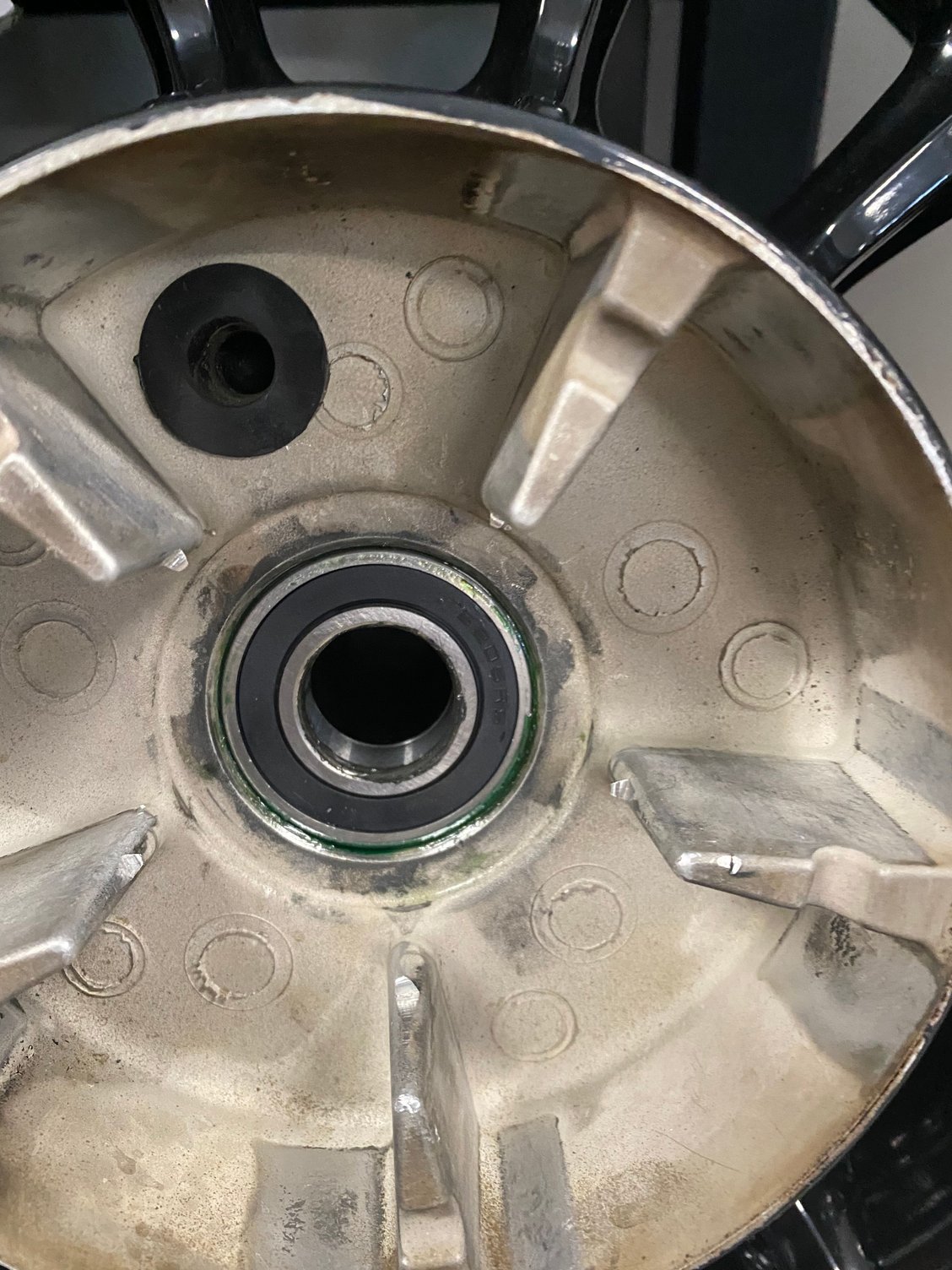

Here is the bearing that is in question. I have heard the only way to get them out is to heat them way up. Isn’t that tighter than a press in?

not really experienced in wheel bearings here, but seems to me that you would not want to heat the bearing up as that would make it expand and therefor be tighter in the hub. wouldn't you want to cool the bearing, heat the hub, or both?
OP, I'm confused, your original post mentions a bearing is too loose, then you're mentioning heating up the bearing to get it out? did I miss something? I recently did wheel bearings on a Talon rear wheel, and used my Pit Posse bearing kit, no heat or any other measures were necessary....
