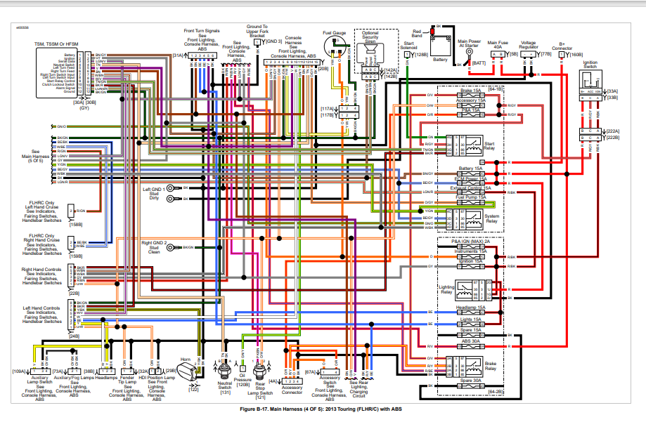

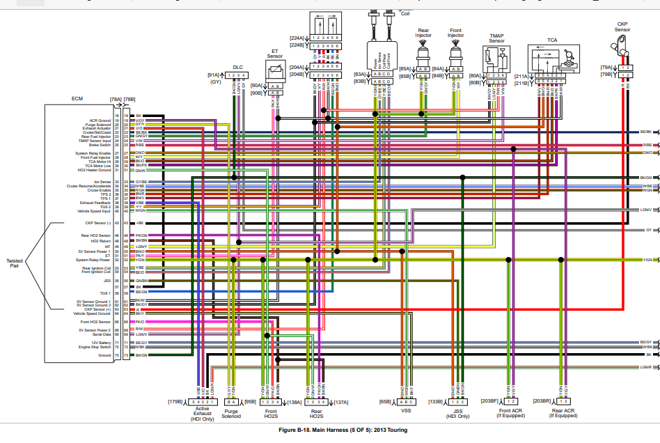

Welcome from Utah.
Check battery voltage while cranking, must stay above 9.8V
Make sure all your fuses are good - instrument fuse .
The fuel pump is controlled by the system relay, it comes on for a couple seconds the shuts off. The ground for the system relay coil is controlled by the ECM, ign on turn the run/stop to run and the relay coil is grounded for 2 seconds. When the ECM sees an input from the CKP, engine is rotating, it grounds the relay so the pump runs continuous.
