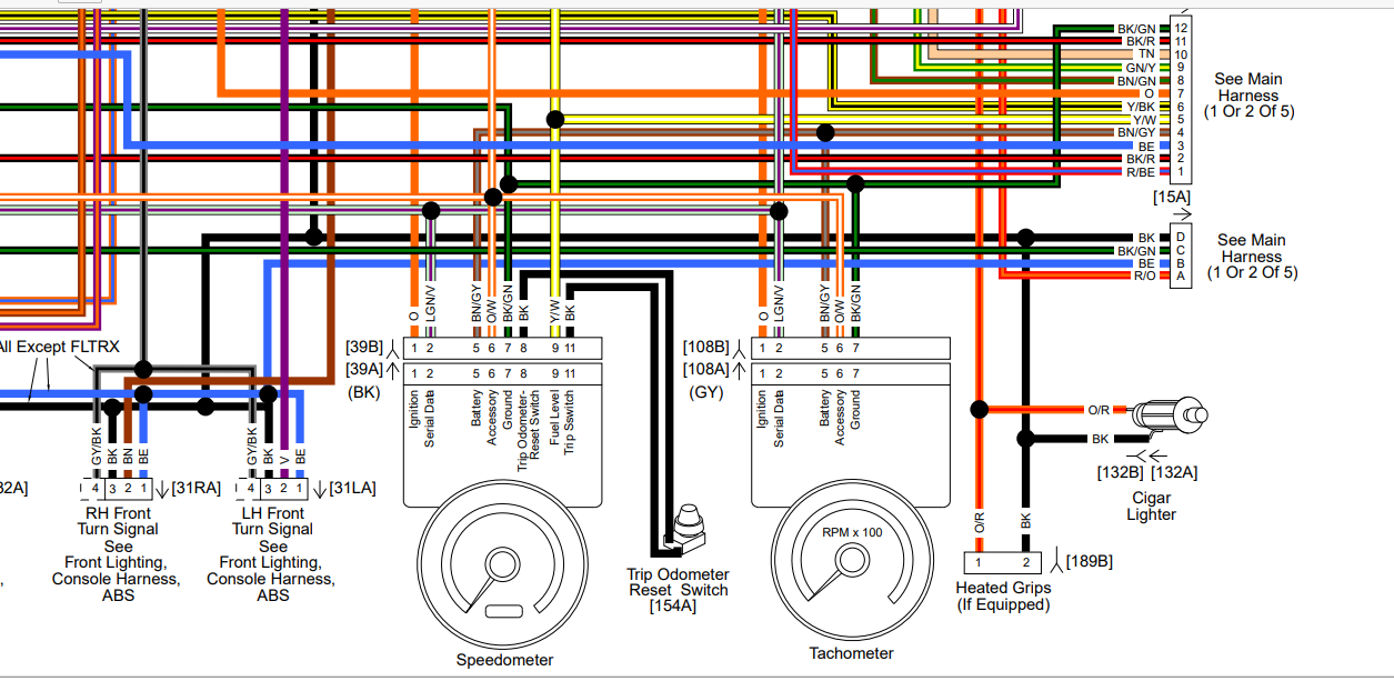

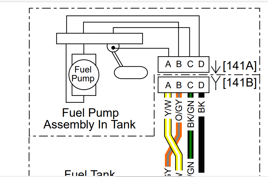

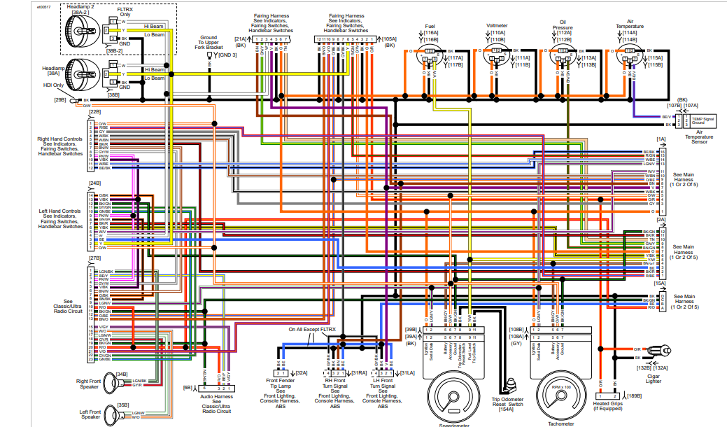

I don't see how the gauge could cause the bike not to start. Unless.... was there any work done to the bike recently? Did you check for codes?

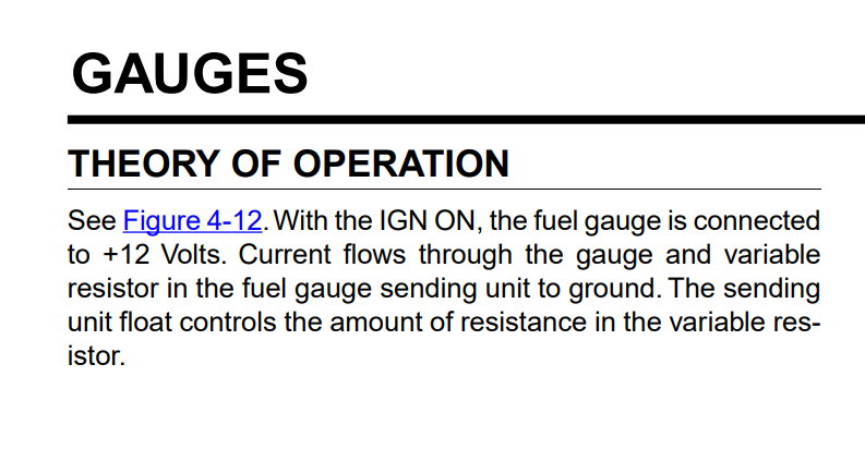

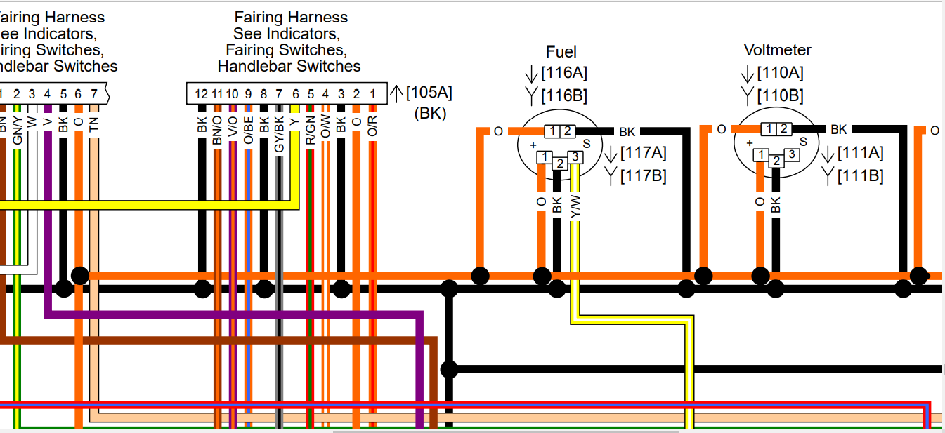

I'll post instructions to check the gauge but here's how it works. Power is supplied to the circuit on the orange wire at the gauge. Goes through the gauge to the Yellow/white wire, Y/W goes to the sending unit in the tank, which has a variable resistor , current goes through the resistor and to ground on the BK/GN wire. The gauge reading is dependent on the amount of current flowing in the circuit which is determined by the resistance in the sending unit.

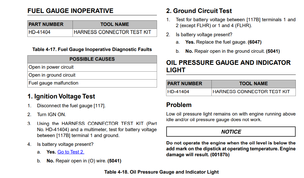

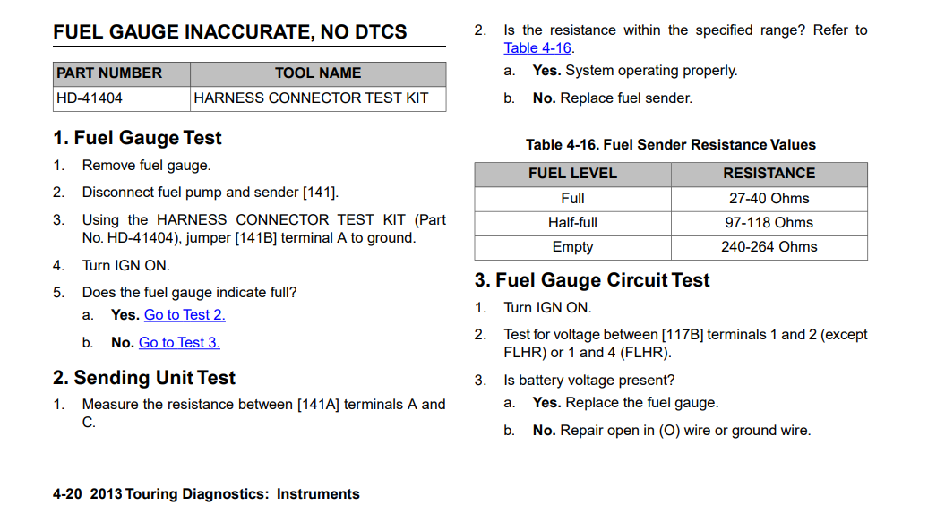

Do the checks below and you may find the problem with the gauge.

Now on to other business, Yes I started with the basics of codes then fuses, battery, key fob... all good. But I keep coming back to the tank gauge not registering fuel and Vernal has zeroed in on methodically checking the electrics. This seems to be the way I need to go. I was going to pull tank internals but I do hear the pump but the more I read, there still could be more in the tank that is wrong.
Thanks
