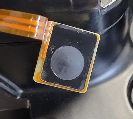

Well I had a busy morning. Did some diagnosing and it appears there is some moisture in one of the connectors on the Tribar. Blew it out several times with compressed air, let it sit for a couple hours. For the most part things are working well, except one of the LEDs still flickers. It may be faulty, I'll keep an eye on it. Oh, CD asked me to do a different sync procedure: start the bike, put the flashers on, run it for a couple minutes while keeping it about 2,000 rpm. They said this sometimes works better.
Next, I opened my right controls to get the part no from my switchpack. There's a lot of revisions, I wanted to know what I had. While I was in there I started picking, and I disassembled to the point of having the actual switch as shown here:
I wasn't ready to peel off the membrane and go any farther. I actuated it a few times and put everything back together. Guess what? It works now. I have no explanation why, nor do I know how long it will last. But I feel like I'm moving in the right direction!
Thanks all for the help!
