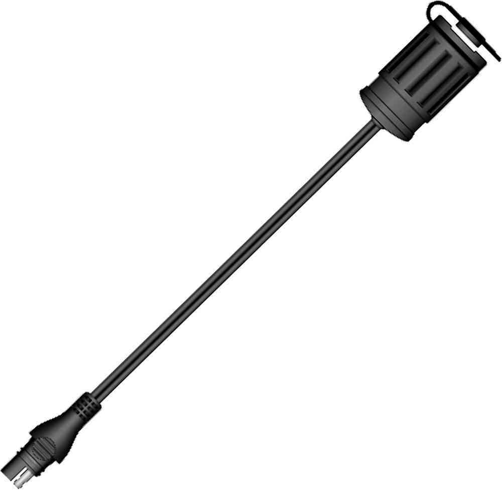

I bought a cigarette lighter attachment that fits onto the trickle charger connector & then routed it so it fits in the right side bag. I think it's Opti Mate brand. I did this originally to power my little portable compressor in case I get a flat.
I also have one of those cigarette lighter things that has a usb port on it so I can charge my phone too.
