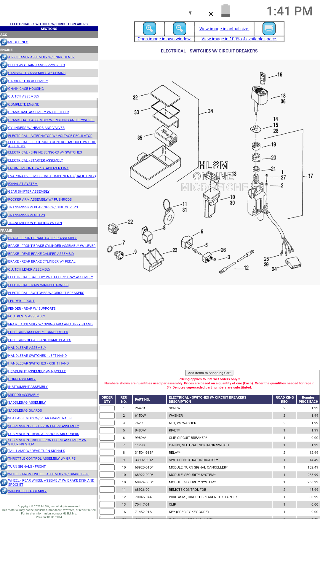

Hello can anybody tell me the location for my turn signal relay or module on a 2002 road king my left front turn signal is not working running light stays on but won’t flash when I hit the blinker

Look on Ronnie's fish. Does the rear work?
http://partsfinder.onlinemicrofiche.....asp?make=hdmc
Think it behind side cover. Its item 10.

Yes back work fine already changed Light bulb also it also dose flash when u first turn on the bike for the security thank you tho
