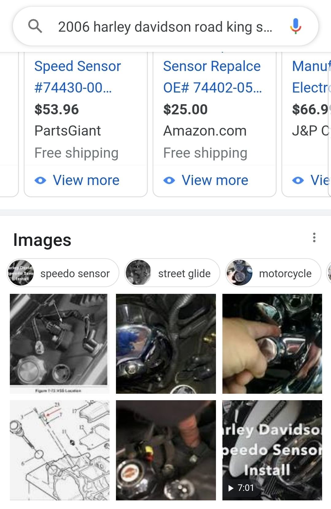

Just type 2006 Road King speed sensor location.
