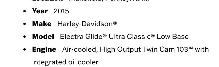

I was mistaken. Seller said it was liquid cooled but it is not. It is a ultra classic low. Not a ultra limited low. Runs great and strong. 103 ho
Not to burst your bubble Friend, but is a plain 103ci. The 103HO is in the Limited with water cooled heads and 10:1 pistons. The Ultra is 103ci with 9:75 pistons I believe or a close ratio. Still a good motor and the 103 is becoming the HD example of a bullet proof motor. That's also from alot of builders of bikes to with that opinion. So you definitely didn't go wrong with your pick , CONGRATS and hope all is still going good with your scooter. Be sure to check your neck bearings every other oil change. Could save your life. Or best take out the cheap Chinese bearings and put in Timken's to be done with it forever.

Maybe so, but All the paperwork I have says HO, and the original air box does too.
