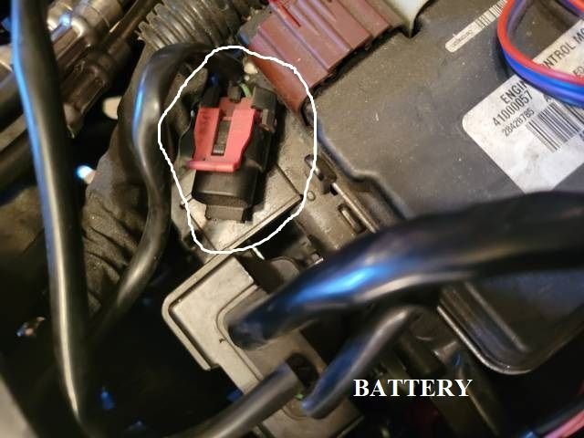

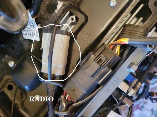

2015 Ultra Limited, The electrical connections are not connected to anything. What are they ?
If any are for Aux Power, what is the name of the connector (Example Deutsch) ?
Connector above radio
Connector behind volt gauge
Connector by battery
-- Labeled RADIO, is a big connector, behind the outer fairing and sits above the radio
-- Labeled VOLT GAUGE, behind the outer fairing and sits near the back of the volt gauge
-- Labeled BATTERY. under the seat near the battery

They are for adding additional HD items. Some bikes for what ever reason come with the additional harnesses from the factory and others don't. For example the Road Glide Special has the heated grip wiring already run to the front of the bike but the regular Road Glide doesn't. And for what ever reason mine has the plug up front for the heated grips but it wasn't connected in the back under the side cover......

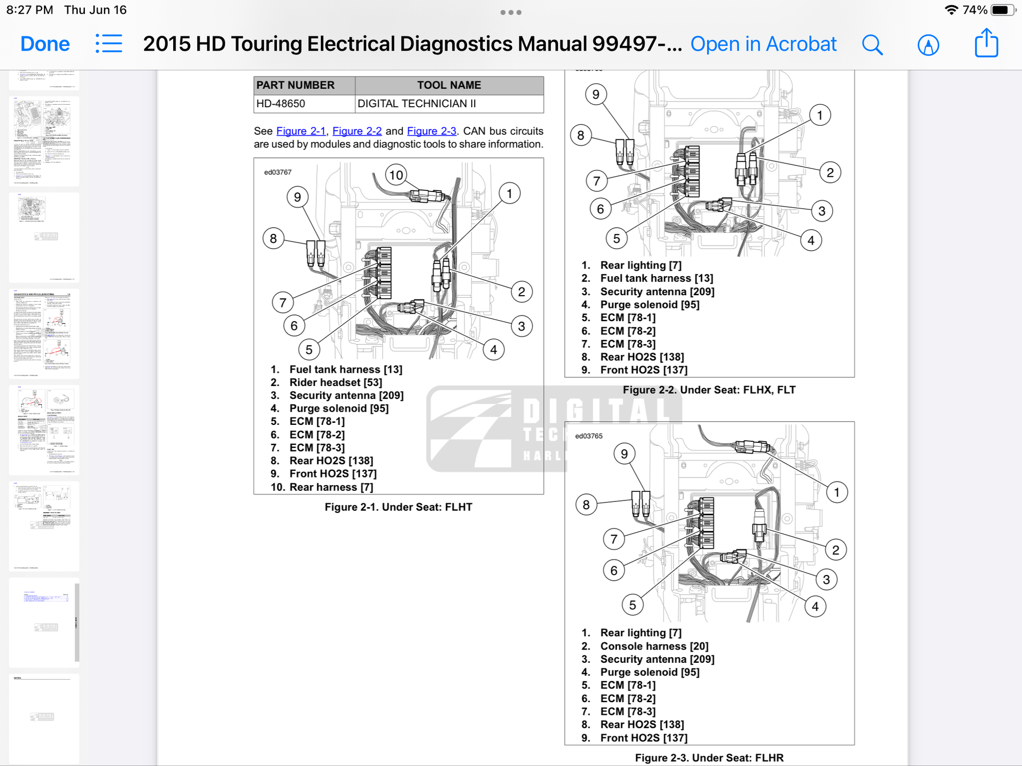

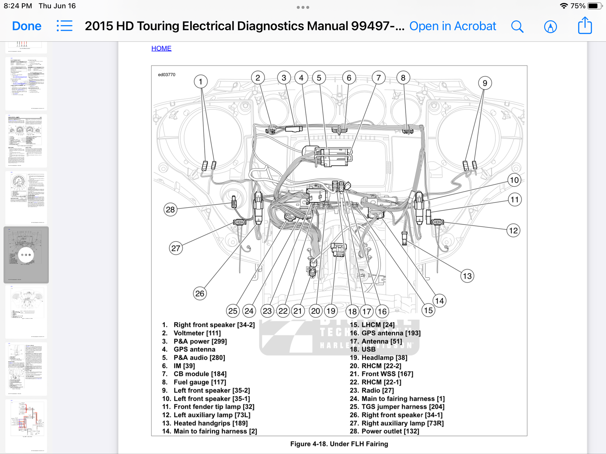

If you have a service manual, you can use the wiring diagrams in the back to trace the wires by their color(s).

Appendix in the back of the service manual will give you all the connector types:

My guess is P&A audio 280
P&A power 299
Purge solenoid 95
