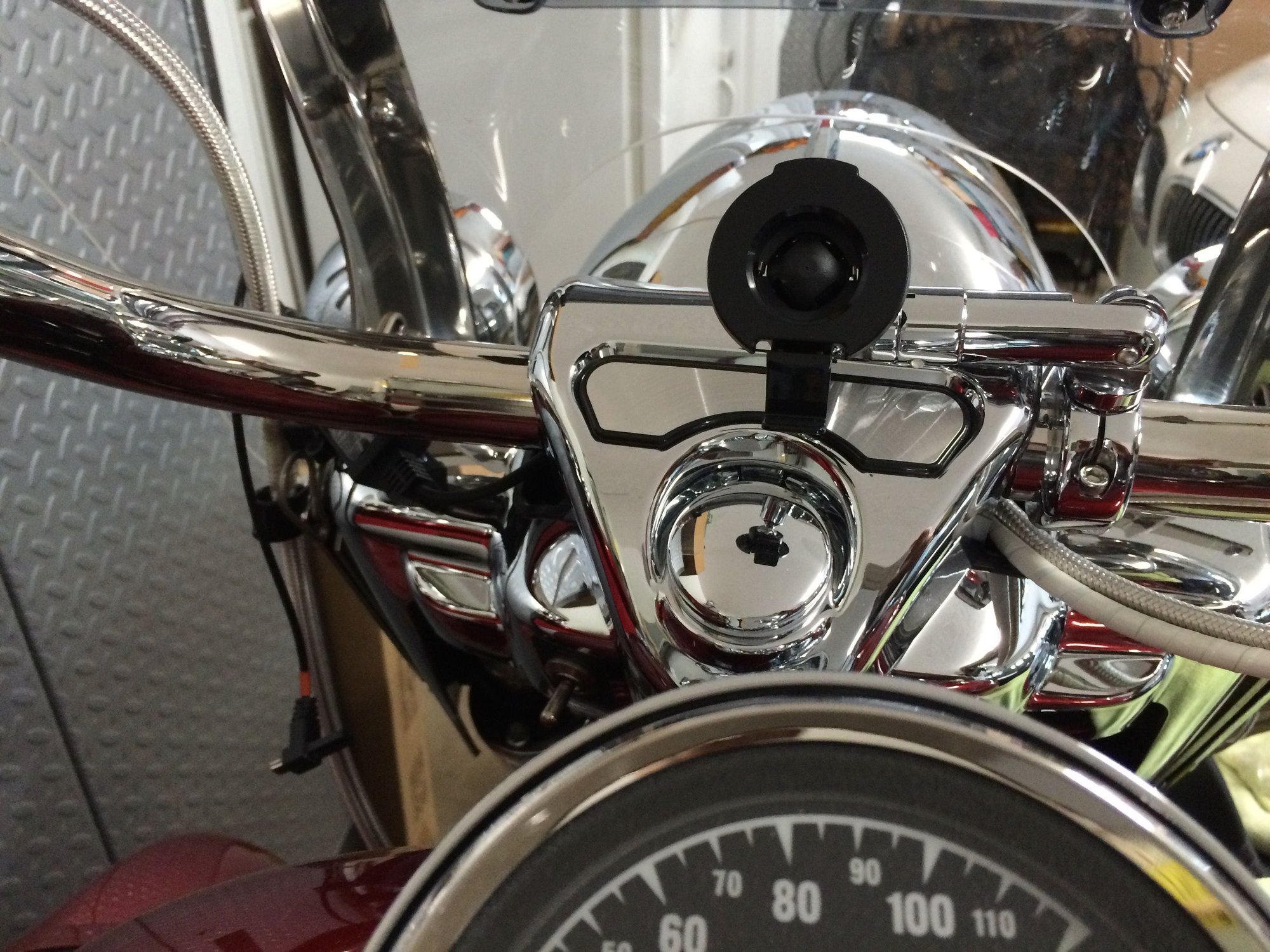

Likes: 1,978
Could be dirt and corrosion. When you get it sorted out put one of these covers on. I haven't had my King as long as you but no issues and it stays clean.
