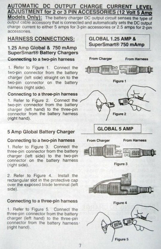

The one in the first pic is what came from the factory on my 2020 RGL. Not sure what the 3rd spade terminal is for but I plug my battery tender into it.
It's been discontinued for several years now, but HD used to sell a charger/tender that utilized the spade terminal.
