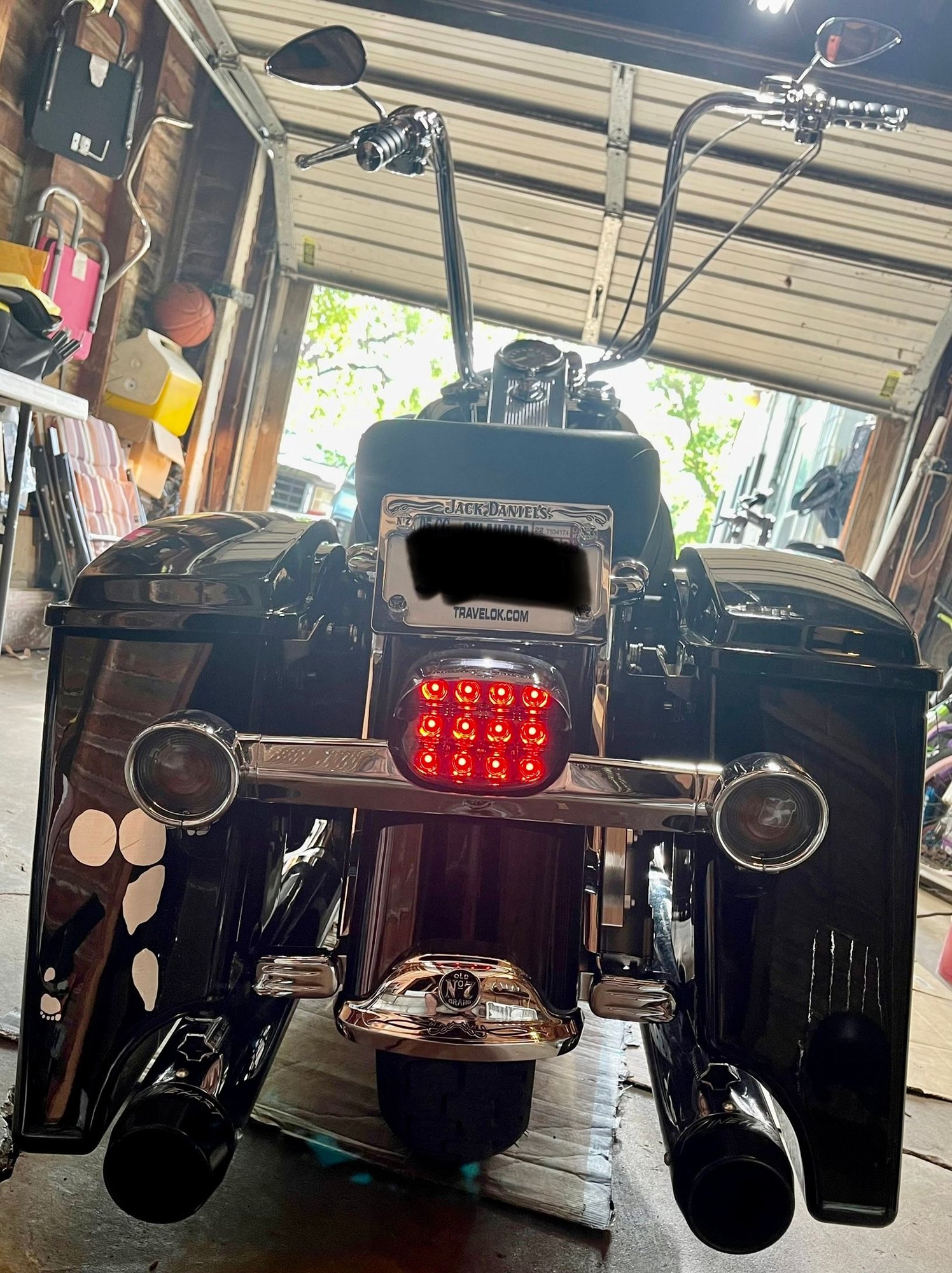

Fellas…I cannot seem to find an accurate answer to my question. Here goes…I am currently running all incandescent bulbs with the exception of my tail light, which is LED. I do NOT have a load equalizer/stabilizer installed. I am going to be purchasing a Standard Triple Play module for Run, Brake, Signal in the rear. I will also install a load equalizer in front of module. IF, I switch bulbs to Kuryakyn LED (Red) will I need another load equalizer? TIA 2006 Road King Classic FLHRCI
