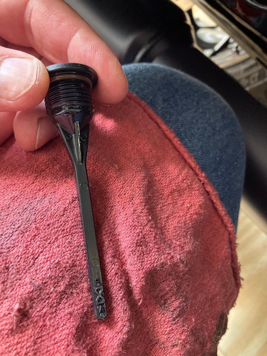

Originally Posted by barneyboy
Can you post a pic of the plastic dipstick? Just wondering if it's easier to see the fluid level. The chrome finish on the metal dipstick makes it somewhat difficult to see the fluid level.
here’s a picture

Originally Posted by bpav16
here’s a picture

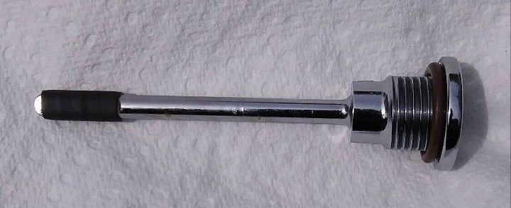

Thanks for the pic! I can confirm a dull black finish makes it easier to see the fluid level. I put a piece of black heat shrink tubing on my chrome stick four years, and many miles ago. Still holding up well.
here’s a picture
Sure hope that says on the stand and not screwed in on the other side.
